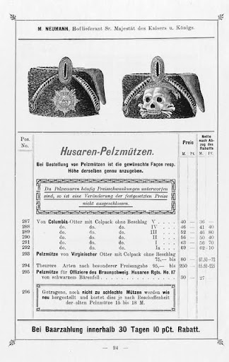

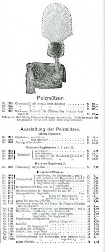

I know very little about these kinds of hats. I do not have one. However I do have several catalogs and in these you can see what was for sale. I would go away from thinking about a wachtmeister hat and think more about what is private purchase and what is issue. Most people of that rank might buy a private purchase job especially if you read about this position in “life in a garrison town”.
For private purchase I have seen in these catalogs otter, possum, bearskin. There is also this interesting little snippet that might be even more interesting. I quickly looked into catalogs and bearskin was targeted towards the 17 Husar.
These catalog pages come from a book that is still in print.
http://www.authorhouse.com/Bookstore/ItemDetail.aspx?bookid=38699
Thanks a lot. I will buy this book.
Funny/interesting to see that bear fur was much cheaper than otter fur. I would have thought it would have been the other way around.
The thing that struck me most is that there are no less than six different levels of good to go for these private purchase helmets. You had to choose which level of good you wanted to buy. This holds true across the board including helmets with spikes on them. However, there are seldom so many levels. Three yes–six is very unusual.
This goes into metal helmets as well as leather helmets. All of this seems to be private purchase–there are other catalogs that seem to cater to the issue crowd–as well as selling many repair parts of many different kinds of helmets. I think these catalogs are great as a resource for what was available.

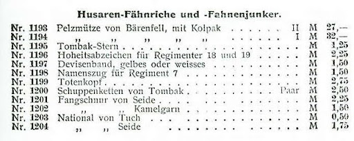

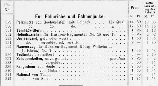

Am I correct in thinking that a Fahnriche and a Fahnenjunker are some kind of officer candidate?
Also interesting to see that one dealer would make busby´s to all the different regiments stationed all over Germany. I would have thought that one or two dealers in each garrison city would keep the local regiment supplyed with private purchase busby´s.
Yes indeed–I would of course recommend the other book in addition to the catalog if you want to understand what that is all about. It is certainly not a straight line. Also explained are the old rank names such as Aspirant.
