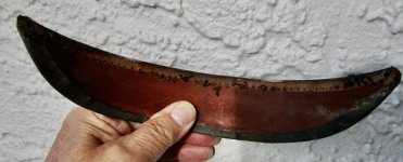

Viser off and stitch holes have been cleaned out. Trench mud still present on the wappen.
The original threads were ripped apart as the helmet shell shrunk away from the visor. These have to be cleaned out and more mud residue on the right.
Sometimes radical solutions have to be used in order to achieve one's goals! ;) To be continued....
