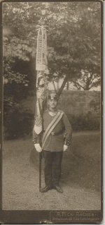

Can you give me some information regarding the feldgrau dress wear by my Flag bearer? Does he wear the uniform wear at the beginning of the War (his shoulder straps looks feldgrau to me)?
RichardYes.
Is it possible for you to date approx. this photo?
Richard
Here is another good one
Then it can only be TB No.6. Munster, where the photographer was based, is near Hannover. Königsberg is many hundreds of kilometers away.This regimental standard has only the 1900 Banderole without the clasps, best I can tell, so according to my reference that would make it TB Nr5, Königsberg (1913) or TB Nr6, Hannover (1914)

Very good information and deduction! Thanks!Then it can only be TB No.6. Munster, where the photographer was based, is near Hannover. Königsberg is many hundreds of kilometers away.

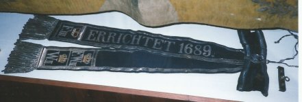

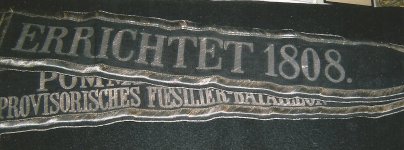

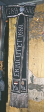

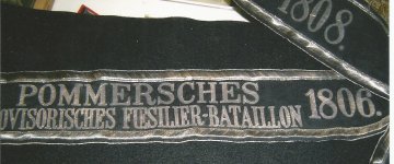

Here are some of the 1900 Banderoles in my collection.
SteveView attachment 51020
Superbe! Can you tell me where these flags are displayed?I R 92 and H R 17
Some years ago, a collector friend of mine
was there and took these photos and sent them to me
I wanted to show them before I filed them away.
The H R 17 flag has an 1813 Iron Cross pole top
Very rare
SteveView attachment 51031View attachment 51032
