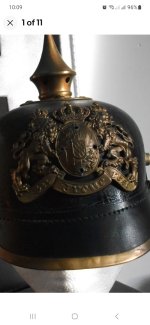

I'm new to buying picklehaube and have nearly Been stung twice now with either fake or just scammers online. I have found two helmets of interest to me here is one and its stated as being;" a bavarian o/r reserve pickelhaube in brass to either 22 IR or 28IR" please see the pictures and what do you think is it genuine and what's a realistic uk price?

Dave- top one looks ok, Bavarian M95 if marked IR 22 then ok, if it is IR 28 then not Bavarian, I would then pass.

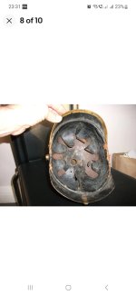

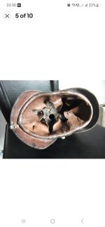

In my eyes the first helmet has been reworked too. The nut of the backspine is hexagonal, which is not original. Do you have better photos of the back of the Bavarian helmet? I can’t see much thread on the right side and would check if the stitching is ok.
Hello, thank you for your help and information, so happy to have this forum, so many fakes or scammers out there and being new to it and even reading up on the helmets. I thought its better to get a second opinion from collectors. Please see the attached pictures attached, let me know what you think. Thanks

The first helmet is missing the reserve cross. The four holes remain on the bavarian wappen
Thanks, to understand this the Bavarian helmet wappen is the wrong type for the helmet? Please see pictures any information is really appreciated. Thanks David

Welcome David,
The Bavarian helmet looks reworked, but as far as I can see it is a period rework, i.e. done during the first world war. Old holes for the Wappen seem to have been properly covered, and the rear visor seems too thin and too dark for leather and still in very good shape, so imo made from Vulkanfiber which is probably the case with the front visor also. This was typical for older helmets that were cut down (lowered in height) and then fitted with new front & rear visor. I have a similar helmet: https://www.pickelhaubes.com/xf/threads/original-m15-restoration-conversion.11302/post-79653
The Wappen however is an incomplete Reserve/Landwehr officer type, while the helmet is other ranks.
Strangely enough, a helmet without Wappen, Kokarden or chin-strap is not worth very much, maybe 150-300 GBP. A complete, common type, helmet on Ebay might cost 600-750 GPB, with prices of 250 GBP for a chin-strap, 100 GBP for the Kokarden and something similar for the Wappen, the remaining value of just the shell without any of these is 150-300 GBP.

If u said the marking is IR22 then it shd have the bavarian infantry wappen. There are 4 holes on your wappen such means it's bavarian reserve such the markings shd be RIR22

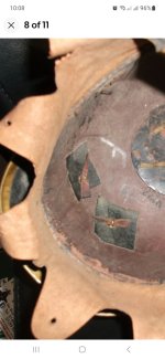

liner also seems to have issues

Dave, this is the area where I can’t see the thread and would check:

Thanks for posting your Wappen Brian,
so I was wrong when I said that the voided Wappen is for officers?
Lars
You are welcome Lars. I don’t know the answer to your question, perhaps James can as he is the primary Bavarian collector that I know of here on the forum. I do know that the usual voided crowns rule which works for Prussia and other states doesn’t seem to apply to Bavaria.
Lars
For Bavarian plates the rule with the voided crown for officers applies to the small crowns of the side lions. But it was not consistently followed, because there were also officers' plates without voided crowns. However, you can differ the Bavarian officers' plates and enlisted mens‘ plates by their sizes.
