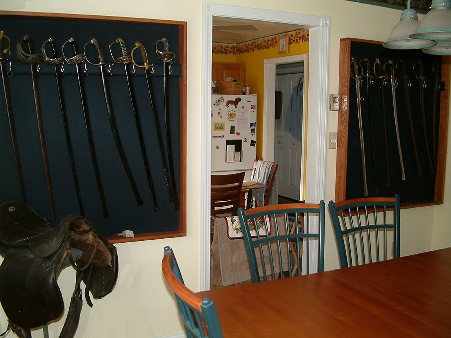

Tony without Kaiser
I made two sword display cases and had them on the walls in the Dining Room of our old house.
Each was a simple square frame, no backing. Each was as tall as the longest sword.
Then I installed a horizontal piece across the top 1/3 to hang them on. Then I covered that in black automotive cloth.
Then I made a backing to fit perfectly inside the frame, and covered that with black cloth.
Then each sword was hung on the horizontal bar with ordinary shower curtain hooks. This allowed to move swords around as I added or arranged them.
It was very cheap to make, worked perfectly, and looked great.

Nice job on the sword cases Tony, and a very impressive array of cutlery there! :thumb up:

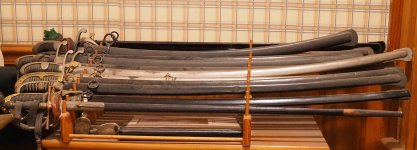

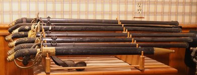

I use two styles of racks to hold swords. Both are simple to construct and can be adapted to swords or bayonets of any length. The first two are made from wood planks cut in a triangular shape to act as bases with dowels used as stringers to set the distance apart. Short dowels are then set into the upper edges of the bases to keep the swords separated.
The second style is merely two oak strips mounted to a wall with short dowels forming a ledge for each sword. The dowels are installed at a 5 to 10 degree upward slant to keep the swords from falling off the rack.
