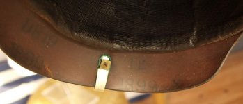

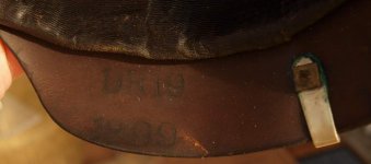

Another example worn in the Oldenburg DR19.
The wearer had the rank of a Wachtmeister at the end of his 12 years active duty (Senior Portepee Unteroffizier).
After his two regular years of duty, he decided to commit (Kapitulant) and was equipped with a better helmet. However, this helmet remains a regular Kammer issued helmet!
Here we have this old fashioned Eigentum liner again. This example has even been marked by the BA X (X), the unit (DR19) and the Eskadron Kammer (1E) and dated as well (1899).
Philippe
Louis

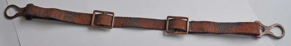

I've managed to acquire all the ingredients for the 1876 Lacquer recipe with the exception of the Mastic and the Sanadarac which I've ordered from ebay. While these two items are in transit I repaired the chin strap which was in two pieces using Tony's stacking and bevel cutting technique. Applying a thin bead of leather glue to each piece worked quite well and you'd be hard pressed to see where the bond is.
It's very apparent that the chin strap was originally finished in black on the outer surface. My inclination is to restore it but the leather is fragile. Maybe I should be thankful that it is back in one piece and just leave it alone?
