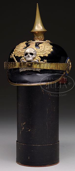

This one is doubtless. It is the example donated in 1961 to the Rastatt museum by Viktoria Luise, Wilhelm II's daughter and Herzogin von Braunschweig. The helmet belonged to her late husband, Ernst August von Hannover (III), Herzog von Braunschweig, usually pictured in HR17 uniform. The helmet is a post-war production. The skull is more rounded, less emaciated than earlier officer examples seen on the forum. A similar pattern can be seen in the Junker catalogue. This special helmet has been previously amply commented upon, on this forum, by those who had a chance to hold it, including Tony S, Garde Ulan, Sergio Semino, and myself. Since John’s question was principally on death head/bones attachment on 92R officer helmets, I have made relevant photos. In fact it is the same bolt/nut fixation as on all genuine 92R helmets I have encountered so far, enlisted- and officer type.

Oh yes! I remember that beautiful helmet well. It had the typical inventory mark (number) of Rastatt museum inside a corresponding index card with the same number and the note that the helmet was a gift from the daughter of the last emperor. It is a pity—and rather incomprehensible—that the museum later gave away such an item.

Around 2002, Sergio Semino had the helmet. In 2014 it was auctioned in the USA, and I assume that it is still there. Perhaps it is now in the hands of a member of our community?

As Garde Ulan wrote, a collector acquired the helmet from Rastatt (not a rare occurrence then). Much later on, it was purchased from a well-known European dealer by publisher Robert Haskell III.
James Julia Inc. auctioned Haskell's estate in 2014.
I attended the auction. From Boston airport tarmac we were five, pilot included, squeezed in a small single-engine aircraft. Safety belt dispensable, and off we take to Fairfield, Maine in nasty winter weather. Quite a thrill!
I have attached the inventory slip from Rastatt museum, and original tag from display cabinet.
