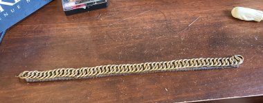

So I have replaced the black leather on the chin chain with the proper brown. I found some soft leather on Etsy that looked close to the leather in the sample pictures Patrick posted. Found the exact right width as well so just had to cut to length.
I have gained new respect for those that sew leather and I can't imagine what the average working day for the people who made these back in the day (or those in India making reproductions) would have been like. This has to be totally hand sewn.
I used an awl (my new best friend) to carefully punch the holes beforehand for the sewing around the edge of the two pieces and for the holes to attach the chain chain.
I have posted some pictures of the process. I also avoided my mistake from last time where I bunched up the chain by attaching each end of the chin chain first and then working my way from right to left to do the rest of the sewing.
I first sewed one side of the two pieces together. I then sewed the chin chains to the bottom piece of leather. I then finished up by sewing the remainder of the edging for the two pieces of leather.
