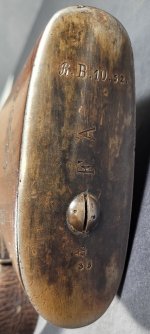

I just looked at my Chassepot and it is just Iike yours: new barrel, modified rear site (French distances removed and new ones for the 11.15x60R round added) French stock markings removed and German ones added, etc.
Mine has a Chassepot sling, and appears to have been marked to a French Navy unit, with Bavarian unit markings (10th Regiment Reserve).
