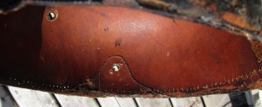

Baden had only one Pioneer Battalion No. 14 created in 1850, based at Kehl, XIV AK. The problems.....both visors and liner have been glued on. Original liner must be replaced, tears and covered in glue residue. Front visor trim (original) which is officer style does not fit and is an obvious replacement, it does not belong on this helmet. Fortunately, I have a piece of original OR neusilber trim which can be used here. One plus to this piece, is that the finish is in excellent condition, one of the best I have seen! The before photos:

The spine brad has to be re soldered. We do have the remains of the original liner which will be shown later. You can see 3 patches of torn liner glued to the shell in this photo.

The visor stitch line has been cleaned out and some of the liner stitching but you can see how close the liner was stitched to the rim of the shell. Once again the glue and remnants of the liner are going to have to be carefully cut off with an Exacto knife.

Don‘t know why somebody glued the Visor, many of the holes seems to be intact, right?
Yes Sandy, the stitch holes are in good shape although the ones for the liner are very close to the edge of the shell rim. I believe glue was used because the thread had rotted out and the person that did this was either too lazy or did not know how restitch it. The new liner is a perfect fit,
