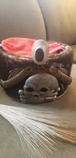

I am new to the site, so I hope I am following the rules. I will be posting all 6 headgear items that came with the collection in the correct categories i hope.

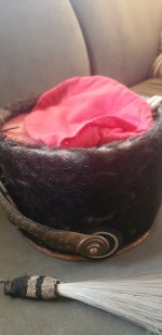

I mainly collect wwii helmets so my knowledge of these is very limited. I recently acquired an amazing collection of WWI German headgear. Any info you can add to what I have would be appreciated. Please point out the flaws if any.
Model number?
Unit number?
Does the red denote something?

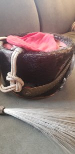

How does the Plume get attached?

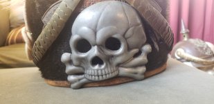

Does the skull look correct?

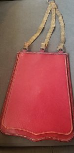

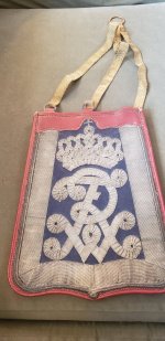

Does the sabretache go with it? If not, any info on that would be awesome. 16675707401967898111741537858228.jpg16675707807378117927137619953270.jpg16675708050829082238354025951989.jpg16675708307036932632851502731369.jpg16675710788746268725265054551168.jpg16675714500467684988607956867617.jpg16675714769795174256328050280305.jpg

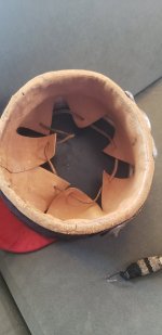

One thing that struck me was the "GERMANY" export marking on one of the flaps of the lining.
Most of the sum of the parts look original to me, and of private purchase quality. But the liner and cockades on this looks very much like an enlisted man's.
Yank off the later-applied repro skull, and you have what appears to be a nice, period, privately purchased enlisted Busby from the 11th Hussars.

No , I have not seen this in 52 years of collecting

I like this Busby for what it appears to be. I would buy this in a second if the price was right. And when I got it home, I would yank that skull off, first thing.

Did you see the "Germany" export mark on the flap?
The shell is obviously bad. How about the other parts? The liner looks okay to me, just never worn and stored nicely.

I did see the stamp on the liner
I was not able to read it
I thought about asking the owner to do a photo of it
but I didn't
I don't like the bush or cord
also the Feldzeichen is a reproduction
I do see a small part of the bamboo frame
which is a big plus

Steve, please ask if you need better pictures. It came with extra parts, so the cord may be the wrong one.
There is bamboo inside, ill picture if I can.
Sorry to be the herald of bad news but thought you would prefer the unvarnished truth.
While the sealskin covering and what looks to be the wicker body may have a shot at being original the rest of the busby needs to be put out of its misery.
Look at the liner. There are obvious joining marks and odd cuts.
Even the Sabertasche is fake. The lace looks convincing but look at horrendous stitching. It looks like someone was drunk while driving the sewing machine...
I don't agree that it all a fake
the 3 hangers are not correct, but I think the rest it is

Not sure that I understand this post
Welcome to the forum Stahlhelme and thank you for posting photos of your helmets. This forum thrives on discussion and exchanging information and this piece has certainly promoted that. 🙂 I only own one legitimate busby so, I am no expert. I also got sucked into buying one similar to yours decades ago and I still have it. Mine has some original parts but it has been faked. Regarding your question about the plume, you need to straighten out the wire on the end of it and slide it into the slot behind the silver/ black feldzeichen. This wire is also suspect as it should be a much heavier gage and stiff. The repro skull on this has obviously just been stuck on, it should not stick up above the bandeau ribbon and below the rim of the helmet.
