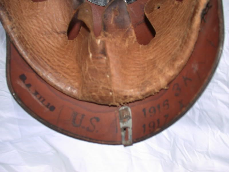

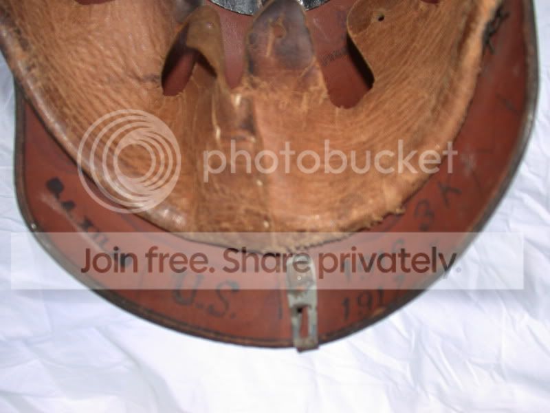

Here is an anomaly from SOS 2015. This helmet was repaired by a BJA.... which one?
obviously there are two sides with vastly different marks. Looking at the right side, the mark is very similar but much clearer than the one we had on the list.

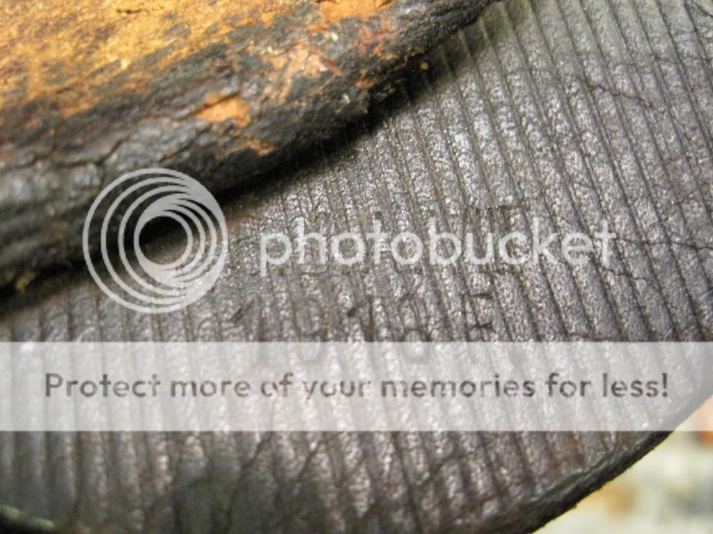

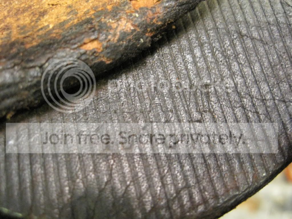

Old picture
new picture
while we know what the G is we do not know why it has a A in conjunction with it.
I have no idea – yet – what the W is all about. It was too blurry in the first picture but is obviously there. BJAXI.
Now looking at the left side there are unit marks and a marking for BJAVIII pressed into the rear visor.
Then take a look at the unit mark. What exactly does it say? The F looks pretty deceiving.
3. Thüringisches Infanterie-Regiment. 3rd Bn. IR 71. It was in Army Corps XI
Well done Joe, I think you have nailed those markings. When I showed it to the Minnesota twins, they both said...send it to Joe, he will figure it out. I wish I had paid more attention to the punched markings though. The "ga" remains a mystery though.
Just read your article Joe on BA markings through the link you posted above. I believe your article contained the answer about the "ga" markings. You mentioned that G represented the German word...garnisonsdienstbrauchbar or in English "suitable for garrison use". I think ga is just a short form taken from the first 2 letters of that word.
