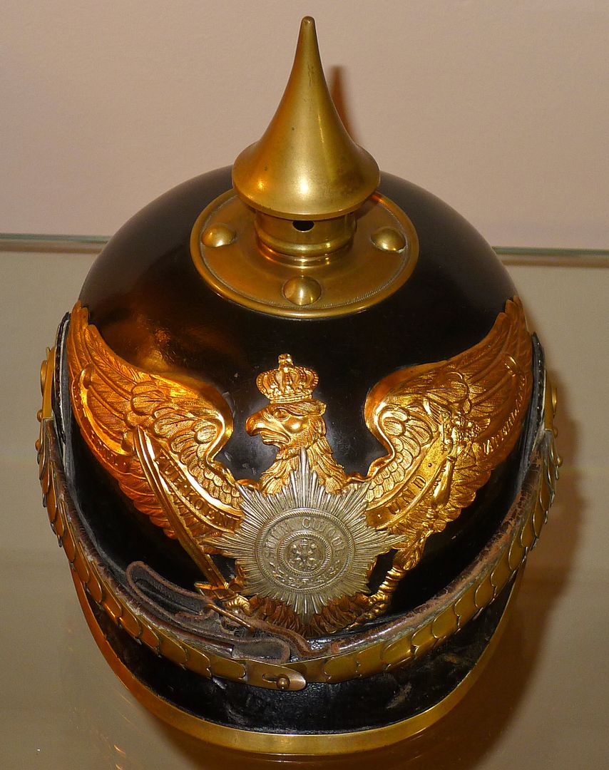

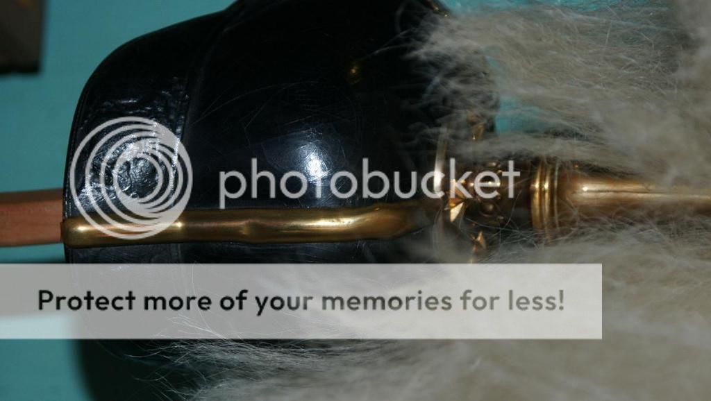

Would appreciate any comments on this recent find. Seems to be Officer's perlring and stars on the haarbush but NCO kokarden and an enlisted man's helmet plate
Helmet is in very nice condition. Appears to be for Guard Train Battalion.
Private purchase enlisted man helmets and the private purchase one-year volunteer helmets can get interesting with the use of officer style parts on their helmets, upgrades on liners, etcetera.
On this helmet I'm confused by the combination of parts, (namely the enlisted pattern front plate and guard star when combined with the other parts) as well as the back spine on the helmet which appears to be an enlisted style back spine.
Hopefully some of the other members will chime in on these combination details.

Normally when you see these helmets that are paid for/purchased by the soldier, you see fancier front plates on them and not just a plain enlisted style guard front plate and the basic quality enlisted style guard star.
I have concerns about this helmet being fitted with an enlisted man's style back spine on this helmet. This would not be "typical" or "normal" for a OYV (one year volunteer) or an Eigetumsstück helmet (private purchase) that has officer style star retainers for the spike base, or the officer style spike, or the officer style pearl-ring around the base of the spike, or the officer style green and red lining under the front and back visors.
If the soldier paid for the helmet and paid for the fancier upgrades, I doubt he would have "run out of money" in order to pay for the fancier style front plate and a swollen style private purchase enlisted guard star, and a fancier officer grade back spine. Those are my points/questions.

This deserves a number of comments. I don't like it. It seems to me that somebody put original pieces together. Very difficult to see from the three pictures but I do not think it is for me.

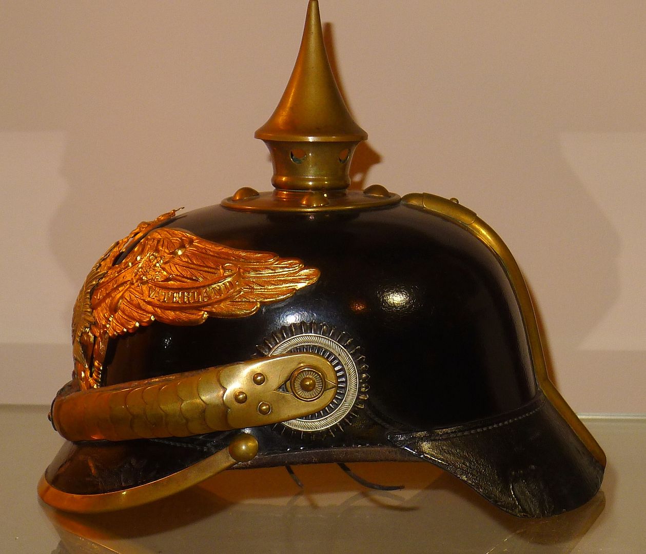

Here's a photo of the enlisted man's pattern back spine for this helmet that was posted on the WAF forum.

Maybe I'm wrong, but my gut instinct tells me this helmet was put together in its current configuration a long time after WW1 ended.

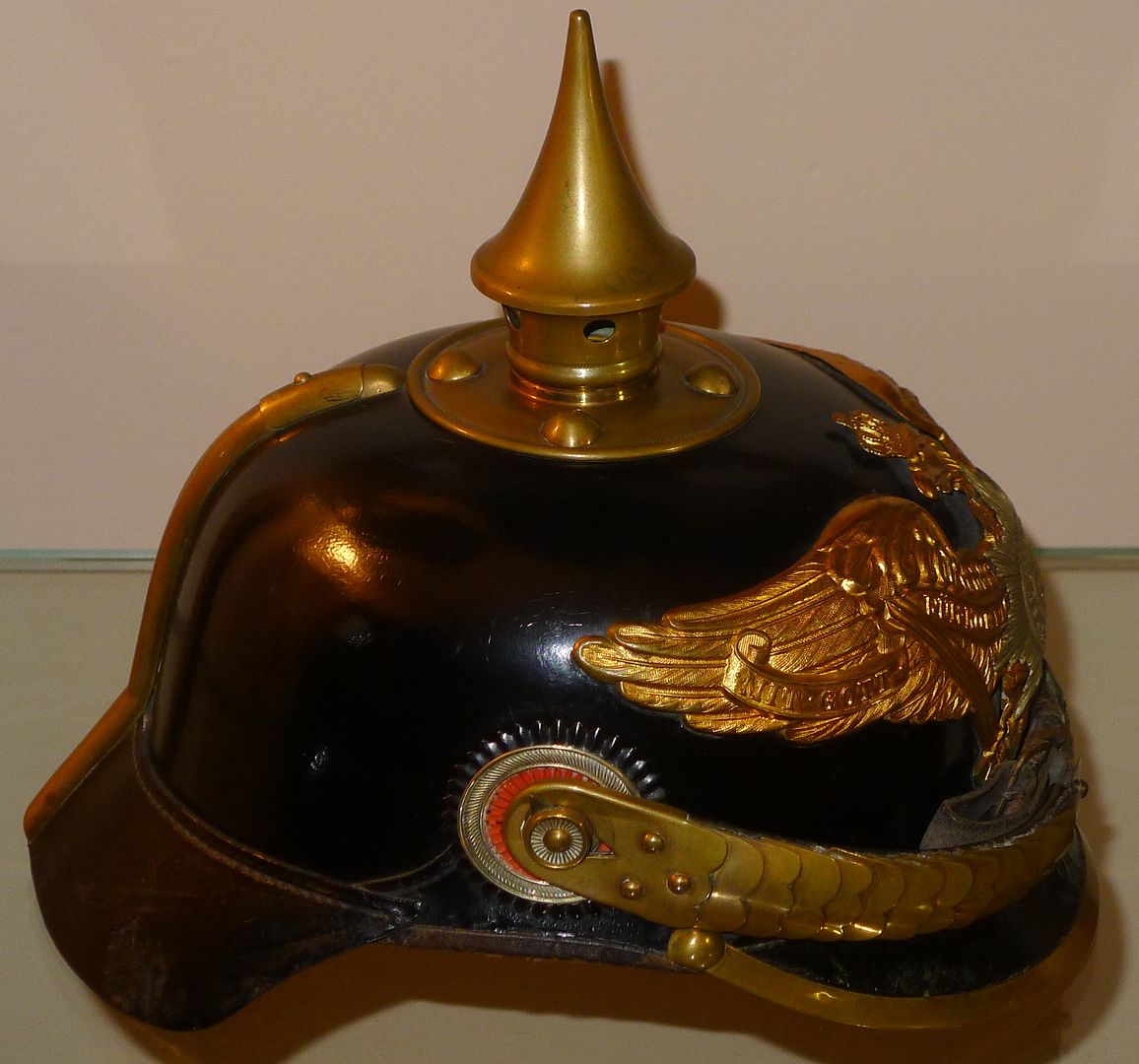

More photos
with respect to the front plate – it seems to be a far higher quality private purchase one in fire gilt and is slightly larger vs. the regular stamped brass type worn by the regular OR

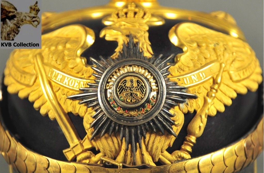

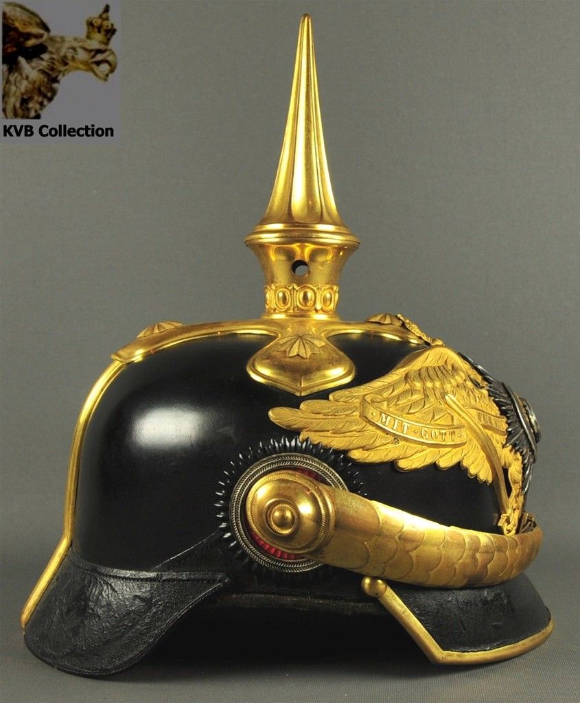

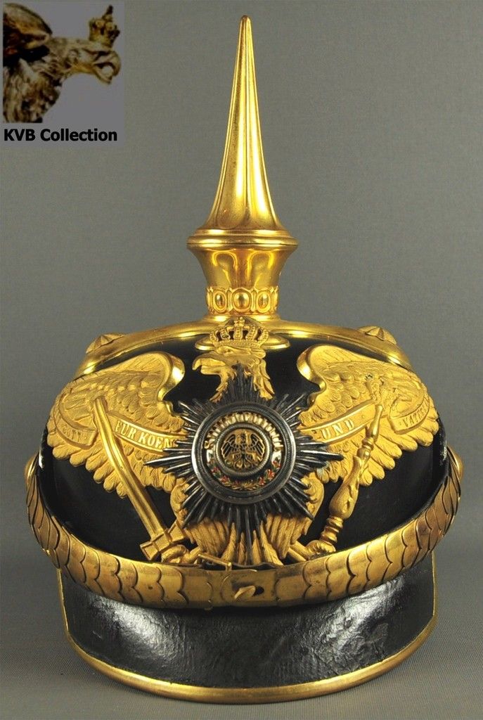

A high quality fire guilded plate looks more like this...
