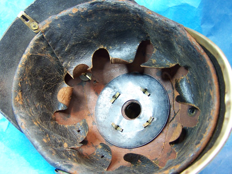

Rebuilding a Grenadier Arty

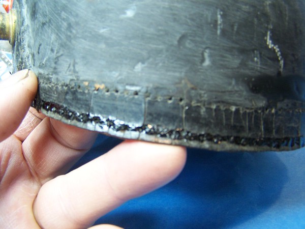

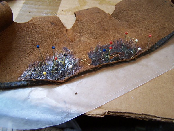

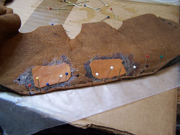

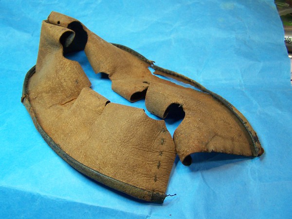

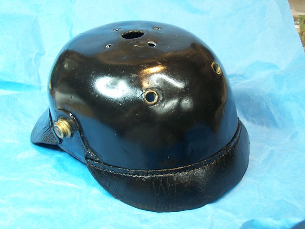

Al right moving along liner repair work .
I used deer skin leather because I was able to skive it thin thin and it remained supple . I used contact leather glue . You spread it on both pieces then touch them together . Instant bond and bendable.

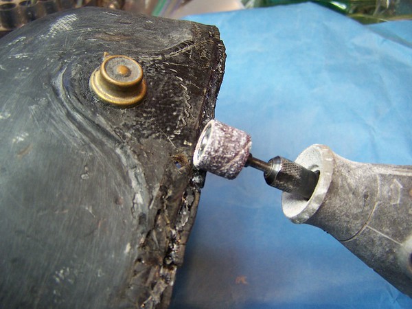

Prepping for liner re-installation.
I will be using thick super glue to instal the liner . I know , I know it should be sewn in but I think that the liner may not make it and may just crumble or be worst for the ware.
So glue it will be.
I ran a bead of super glue over the thread line to stabalize it and give me somethng for the glue to stick to.
Then I smoothed things out with a dremel then repeated the process and Dremeled that as well.

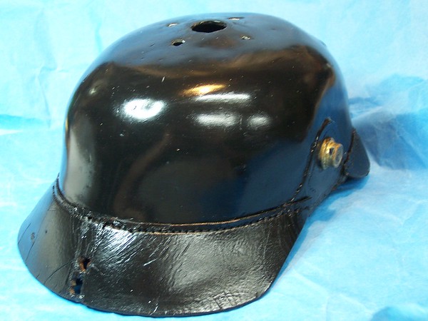

As the liner glue cures out I decided to sew on the visors.
It gets easier each one I do .
But this was a tad easier because I did not have to fight the liner.
Remember dull the point of the needle.
It makes it sooo much easier when fishing for those holes.

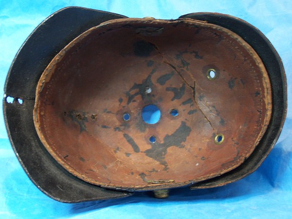

Bills on and 2 coats of black shoe dye.
I will cover everything with shoe polish when I am ready.
The underside of the visor s are BLACK
I usually see this with a fireman's helmet .
Have any of you guys seen this before ?

No these are thick gauge leather just black .

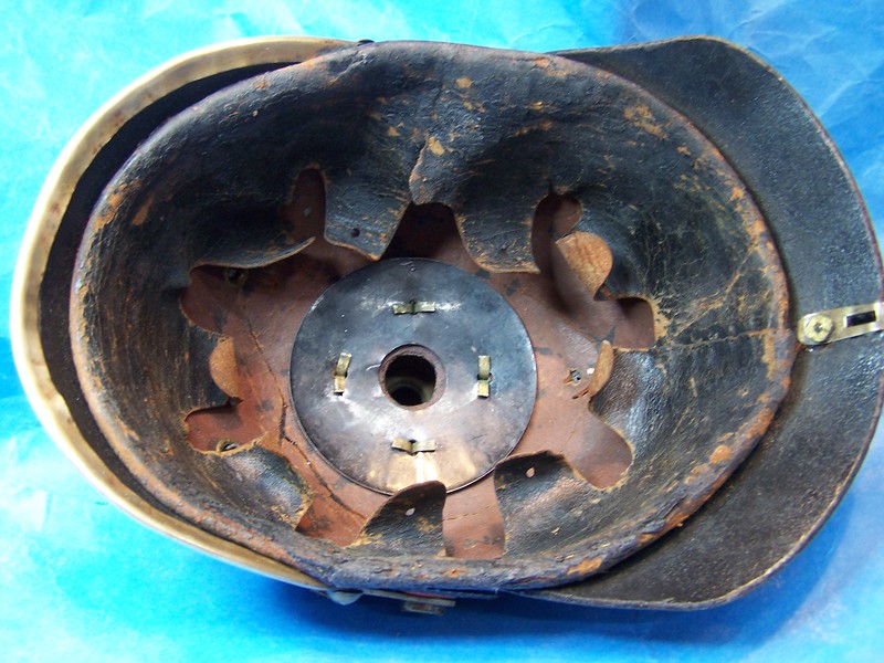

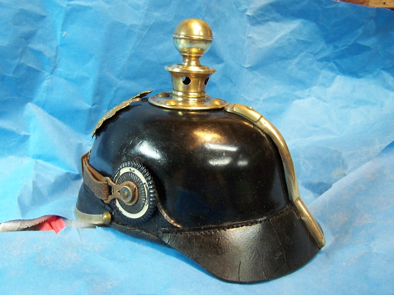

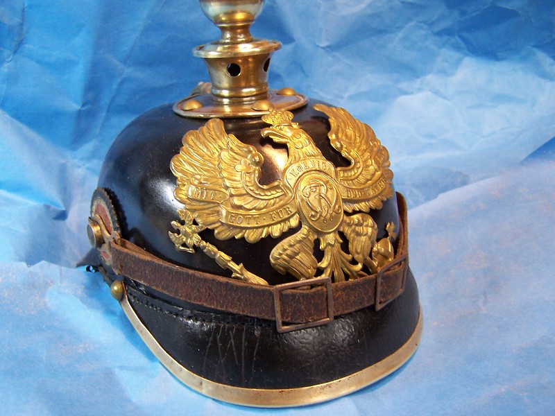

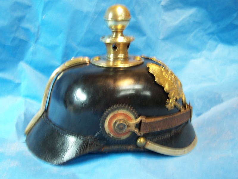

OK guys , I will call this a wrap. After I dyed the shell black I put a coat of shoe polish and that as all ways nocks the shine down just a little that looks much better.
I had to play around with the replacement front visor trim and had to solder a split rivet for the rear spine.
Before
After
Before
[/quote]
After
I stippled black paint mixed a little with white to get a charcoal look and did not cover 100% . After all, this thing is over 100 years old and the liner would not look new.
Although I do have some that do :thumb up: :thumb up: :thumb up:
