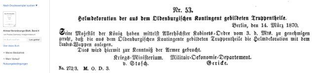

Here are some interesting information about Oldenburg Pickelhauben that perhaps not everyone knows:
As is generally known, there were two Oldenburg regiments, Infantry Regiment No. 91 and Dragoon Regiment No. 19. However, helmets with Oldenburg cockades may also be plausible with stamps from IR30, IR85 (until 1897), FAR26 (2nd and 3th „Oldenburg“ batteries - until October 1899) and FAR62 (2nd and 3th „Oldenburg“ batteries - since October 1899). This is because parts of the military recruiting areas for these Prussian regiments belonged to the Grand Duchy of Oldenburg after the Congress of Vienna. And, as is well known, non-Prussian nationals who served in Prussian regiments had to wear the cockades of their home country.
  • In the case of IR85, however, the Oldenburg cockade was only worn until 1897, because here the mentioned recruits were actually citizens of Lubeck, who until then had belonged to the Oldenburg military recruiting area after the Congress of Vienna. But from 1897 onwards the citizens of Lubeck were recruited into the newly formed IR162 and wore the Lubeck cockade from then on.
  • In the case of the FAR26 and FAR62 it is also a bit tricky, because there was a reorganization in 1899 and the FAR No. 62 was founded. Due to this, the 2nd and 3rd "Oldenburg" batteries were transferred from FAR No. 26 to FAR No. 62, which is why the Oldenburg star and the Oldenburg cockades were only worn on the helmets of FAR No. 62 since Autumn 1899.
Furthermore, I’m sure that the 2nd and 3rd battery of the FAR26/62 wore also the Oldenburg star in silver on their helmet, because acc. to AKO from March 3rd, 1870 all troops which were formed out of former Oldenburg units should wear this. However, I'm not 100% sure if this was also the case with the Oldenburg soldiers of the mentioned infantry regiments no. 30 and no. 85. But according to my understanding of the AKO this may not have been the case, since the soldiers should only wear the Oldenburg cockade because they were Oldenburg nationals. Here the units weren’t formed from former Oldenburg units. Or are there other opinions on this?
