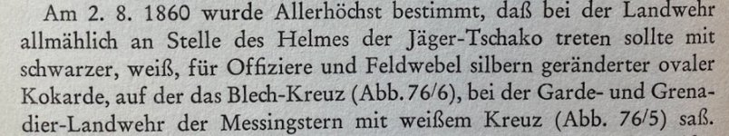

1860 Landwehr
Pietsch p.238
Translation: On August 2, 1860, it was decided that the Landwehr should gradually replace the helmet with the Jäger Tschako with a black, white oval cockade with a silver border for officers and sergeants, on which the metal cross (Fig. 76 / 6), with the Guard and Grenadier Landwehr the brass star with a white cross (Fig. 76/5).
So logically, there was no requirement for issued M1860 Line eagle Wappens with a chest cross, as the Landwehr adopted the Tschako in 1860, and Reserves were not directed to wear the chest cross until 1896. That would explain the gap of eagle Wappens with the chest cross between 1860 and 1881 when the Landwehr started wearing leather spiked helmets again. So there it is. The end to my futile search for M1860 issued Landwehr Eagle Wappen with a chest cross.
So here is the Landwehr Wappen from 1860 to 1881, plus I am including the Garde Landwehr Wappen, as these are not often seen.

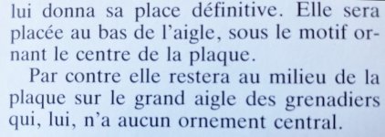

And again here in Larcade Vol I p.35
Translation: The corps of reserve officers was created on July 4, 1868. These officers wore the uniform of the regiment from which they came. The plate of the helmet remained that of the regiment of origin but without the "Vaterland-Bandeau" whose motto figured on the Landwehr cross.
This cross was silver on the golden eagles, and golden on the silver eagles.
An ordinance from the Ministry of War dated February 17, 1869 prescribes that this cross must be fixed in the middle of the body of the eagle, on the monograms or on the star of the Guard. But, two months later, the A.K.O. from April 6, 1869 gave him his final place. It will be placed at the bottom of the eagle, under the motif adorning the center of the plate.
Based on these references, 1868 was the first time that a Landwehr cross was put on a Reserve officer eagle Wappen. Plus it clarifies that after 6 April 1869 Reserve officers wore the cross soldered on the tail feathers of the eagle Wappen.

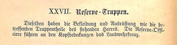

However, I could find no reference to soldiers of the Reserve also wearing the chest cross after 1869, because they did not. In what I call ‘The smoking gun’. Glenn tracked down a scan of the 1869 Uniformirungsliste by Louis Mila, a noted Prussian uniform researcher who lived during that period. The extract Glenn shared was the published 1869 – “Uniformirungs-Liste der Königlich Preußischen Armee und Marine fur das Jahr 1869.
Translation: Reserve Troops: These have the clothing and equipment as per the corresponding units of the standing army. The Reserve officers wear the Landwehr cross on the headdress.”
This clearly states that soldiers of the Reserve did not use the chest cross. They used the same eagle Wappen as the three Line Btlns, as they were to be supplied by the Regiment or Btln they were assigned to. Only officers wore the cross on their eagle Wappen.
If you think about it logistically, it makes no sense at all for a Line Regiment to have a Battalions worth of leather helmets with Landwehr crosses laying around in Regimental Stores all year, in just the right sizes for the Reservists who show up for manoeuvres. Not practical.

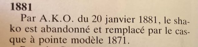

Back to the Landwehr. A.K.O. of 20 January 1881 gradually replaced the Tschako for Landwehr Infantry by the spiked helmet once again. From Larcade Vol I p38
Translation: 1881
By A.K.O. From January 20, 1881, the Tschako is abandoned and replaced by the leather spiked helmet model 1871.
Other references confirm this occurred in 1881. This then is the first instance of the cross on the chest of a Prussian issued eagle Wappen after 1860. That implies that any issued M1871 eagle Wappen with a cross on the chest is (ready?) actually an 1881 Landwehr eagle Wappen. Reservists were supplied by their assigned unit and would have worn the standard Line eagle Wappen with the Fatherland Bandeau. Based on this, below is an M1871 eagle Wappen, as adopted by the Landwehr in 1881.

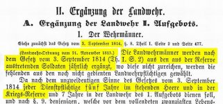

Thank you Tony,
just for completeness, I would add that the existence of a body of reserves was in effect following the law of 3 September 1814 and further codified by the Landwehr-Order 21 November 1815. These decrees stipulated the obligation and period to serve in the standing army (with the colours and in the reserve) and the Landwehr. Although I will not provide a full translation of this extract from Helldorff's Dienstvorschriften (service regulations), suffice to say, it reiterates that the 1st levy of the Landwehr would be supplemented yearly by those soldiers completing their term of service in the reserve.
According to the law of 3 September 1814, all those subject to military service, were to serve five years in the standing army (with the colours and the reserve) before transfer to the Landwehr.
