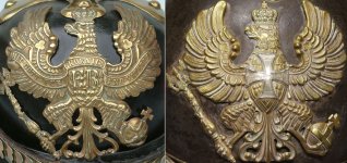

Tony, looking at your picture of the line officer got me to wondering.
This is a plate I got years ago which I always thought had either been 'messed' with or was a copy (or possibly both) as it had both the bandeau and the cross.
It looks good from the front but is noticably heavier than my other wappen and the back doesnt look like a stamping, although it doesnt look galvano either.
Just thought I'd see what everyone thinks.
All the best
Jeremy
Jeremy,
I am skeptical that your reserve Wappen with bandeaux is original. Granted, it is very difficult to make an accurate determination based upon a photo, but I see some issues that I have only seen in copies.
You stated that this Wappen was heavier than other Wappens you own so I assume that this is an early 1860's Wappen made of a heavier gauge brass. It is true that Wappens made of the heavier gauge may not be as sharply detailed on the reverse side, but most of the time they are very close.
I have taken the liberty of copying your photos.
This is the reverse side of yours:
This is the reverse side of a Model 1842 Wappen modified for 1860:
This is made from a very thick gauge of brass.
Here is the reverse side of an early model 1860 Wappen with stamped bandeaux:
This Wappen is also made of a thick gauge brass, but notice, all of the words are readable and somewhat clear.
The most noticeable issue I have with your Wappen is seen from the front, not the reverse.
Compare to modified M1842:
and compare to early M1860 with stamped bandeaux:
The bandeaux of your Wappen seems off center. The word "FÜR" is the most noticeable:
It looks like the word "FÜR" has been spread out like "F ÜR" and the "Ü" dips into the lower bandeaux edge.
Here is a comparison photo showing five different model 1860 Wappens, the last being an officer:
All of these are thick gauge brass and all show the same detail.
The above photos also illustrate the the "K" in "KOENIG" on your Wappen seems to be missing a leg.
This high degree of detail in the bandeaux holds true for every Prussian Wappen with bandeaux I have, from 1860 to 1915.
I, of course, do not own a Wappen from every manufacturer so this could be a manufacturer specific idiosyncrasy.
Just my opinion --- and again, based on a photograph.

Thanks for your detailed review of the wappen. I must agree the detail on the reverse leaves a lot to be desired and the Für leaves a lot to be desired, but the K is all there, just my appalling photographic skills 🙁
I’ve attached a new pic.
All the best
Jeremy

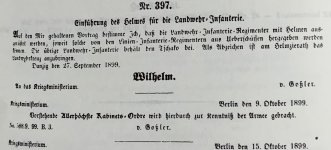

And about the Landwehr helmets from September 27, 1899:
Translation:
I decree that the Landwehr infantry regiments should wear helmets from surplus of the infantry. The rest of the Landwehr infantry keeps the shako. The Landwehr Cross made of nickel silver is to be attached to the helmet eagle as a badge.
