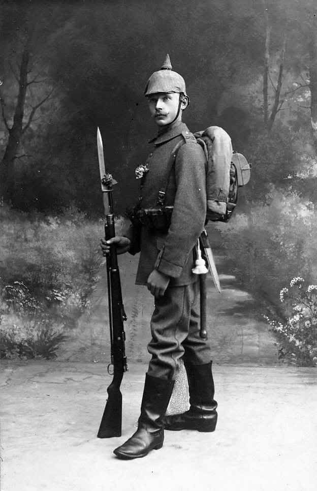

Bayonet knot:
Hmm--sort of looks like it just tied around the Bayonet holder (or frog) :unsure: :

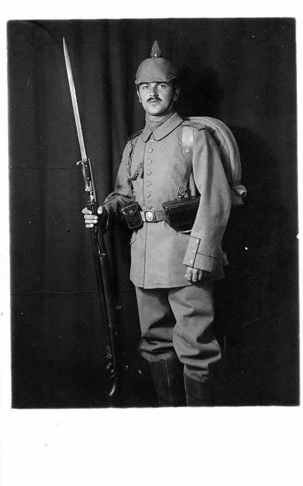

Reserve (R.I.R. 216) soldier, M1910 Uniform; old M1895 Ammo pouches:
You can see the bayonet knot plainly here:
But some Reserve Infantry did have the newer ammo M1910 pouches:
R.I.R. 202 soldier, M1910 Uniform; M1910 Ammo Pouches:

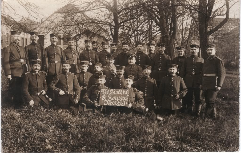

Here is an interesting photo, making me wonder if the Troddeln were changed when a soldier was moved from on company to another, there are several Troddeln visible in the photo, and most appear to had dark sliders and crown with light stems, but the fellow kneeling on the extreme left has a Troddel that has a dark stem and light slider and crown. Given that these fellows are suppose to be from the same Korporalschaft, they would be in the same company, and judgeing by the Troddel, the fellow on the left is not even in the same Battalion.
_________________

Thank you Gus and Joe for all this great information about the Bayonet Knots.
I don't know much about historical guns like the Gewehr 98 or uniforms, so bear with me please.
So, as the photos I posted show, the bayonet knot was not attached to bayonet when the bayonet was fixed to the gun, right??? :-k
So, the Bayonet Knot was used in a similar fashion as the Officer's sword knot, i.e., to secure the bayonet, when wielded like a knife, to the soldier's hand??
So, there was a special loop on the soldier's belt (the so called "frog") that the bayonet holder was clapsed to and hung from??
And you say the Bayonet Knot was attached to the frog.
So, it looks like from the photo I posted that the Bayonet Knot was wrapped around and tied to this loop or clasp.
Was this loop or clasp (i.e., the frog) made out of metal??
From the photos I have, it is just real difficult to see that side left hip area.
A source says the bayonet was frogged to the belt and secured to the carrier of the M98 'short spade' on the uniform of a Fusiler Guards Regiment Unteroffizier.
How was the bayonet exactly conjoined to the soldiers' belt itself???
A hook? A metal clasp? A leather loop??
Also, if anyone has any photos of the frog on the belt (replica photos are fine) and how the bayonet was attached to the belt, I would like to see them please.
 Profile

Hello Gamburd: This photo may help clarify your question on bayonet frogs and bayonet knots. The knot on this particular bayonet signifies the 4th company.
Reservist1

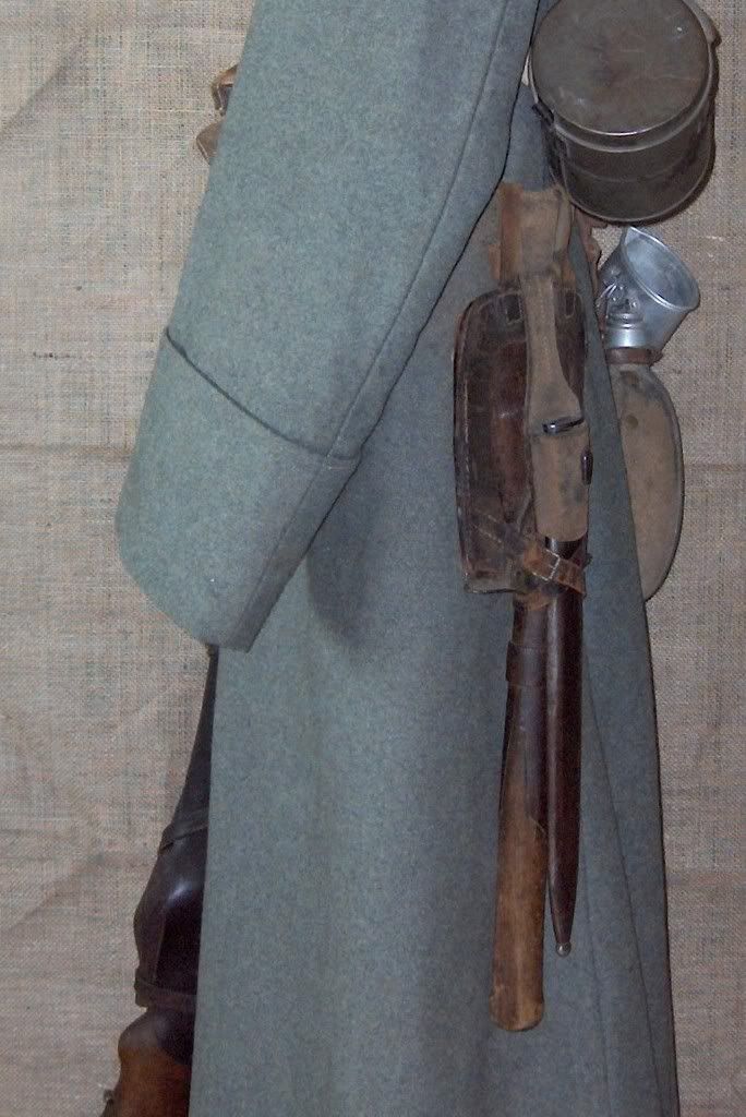

Hey Gamburd,
Here is a shot of the bayonet scabbard inthe frog on the belt (with out the Troddel), with the E tool as a unite, the frog went between the loops that supported the shovel carrier, and the scabbard was then strapped to the scovel handle with the streap that held the shovel. This was done to keep the bayonet scabbard from banging on the shovel handle.
Best wihses
Gsu
