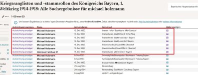

Philippe very kindly provided a copy of Ancestry showing Michael Holzmann's war service etc. So I thought I would subscribe to Ancestry to get details of his post war wound (8 May 1917) service and his subsequent life. I got AI to translate both documents. However I found this record (13825) for a Michael Holzmann which has the same birthday and parents (but wife's born name is Fischl instead of Fickl) and his birth place is shown as Jetzendorf and not Immenhafen per the copy Philippe made. The war service is different but the medals are the same and the fact he was a Kanonier is the same in both.
What is going on!! Is AI making up what it can't read? I am not very good with Ancestry so any advice would be very welcome. I am very confused.🤔
Chris
When I ran it with AI the first time I did two photos one of each side on the book . This time I did it with a picture of the two pages and AI came up with Holzmann being a Railway worker from Ausberg! So I think it is AI that is having the problems. Does anyone know a more certain way to get AI to translate the old German script? Frustrating!
Chris
Sorry to all that I keep coming back . I have now found that a zoomed in image gets read correctly by AI . It must be if it can't read something it just guesses but doesn't tell you its a guess! I now seem to be getting sensible translations. Please ignore my last few posts made out of frustration!

There are all in all 7 double pages for this guy in the Münich Kriegsstammrollen and they are giving all the same informations but completed in time:
Chris, the bavarian Kriegsstammrollen are not always perfect, as the Verlustlisten. Or the people who digitalized the archives made some transcription errors, specially in the names orthograph and sometimes in the birth dates.. Nobody is perfect especially with this old german writing style..
Immenhofen (near Markt Oberdorf) is the only given place of birth and living. Jetzendorf obviously is a IA delirium...
M. Holzmann was Bauersohn and Bauer (farmer, as his father was). His mothers birthname is Fichtl and not Fickl.
On the 21.7.18, because of a foot compression (right foot), he was transfered ton the Kriegs Lazarett Longuyon, then on the 12.8.18 to the Reserve Lazarett Pforzheim and on the 6.9.18 to the Ersatz-Abteilung of the KB FAR 4 in Germany. It seems he never went back to the frontline.
Philippe
