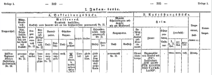

Hi Lars
Thanks a lot. That chart is completely new to me, and therefore all the while more interesting. Now, the branch of my German knowledge concerning clothing production technicalities is not exactly sharp as a knife, so perhaps you can help me - does "gestickt" literally concern one specific embroidery method (such as the literal embroidery on shoulder straps like on 2 and 4), or is it instead more of an umbrella term for all three methods of putting insignia on shoulder straps?
And is there a place where I can find the 1903 regulations online?
Best regards
Bertil
Hi Bertil,
I don't know for sure, but it seems that in this case both on the pre-war blue uniform and on the field grey uniform the same method of stitching was used.
Sandy made a very nice overview of clothing regulations online https://www.pickelhaubes.com/xf/thr...et-and-clothing-regulations.17147/post-121228, with the 1903 regulations at https://www.historische-uniformen.de/fileadmin/downloads/Bekleidungsordnung_Anhang_II_1903.pdf
Lars

Wonderful! This is very fascinating and enlightening reading, thank you. If I understand these regulations correctly, is it then true that the FR86 Schulterklappen for the Feldmantel were made like this?:
Pre-1903: Dunkelblau Tuch, white piping, Ponceaurot wool monograms
Post-1903: White Tuch, no piping, Dunkelrot embroidered monograms
You can have a look in the attached screenshots. In the 1903 one, I accidentally cut out some of the text. It originally said "in dunkelrothem Garn gestickt" at the end there.
Best regards
Bertil
