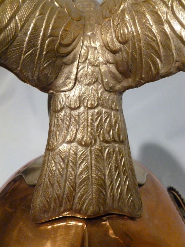

Here are some detail shots I took,
The eagle:
Detail of the face:
(more to come)

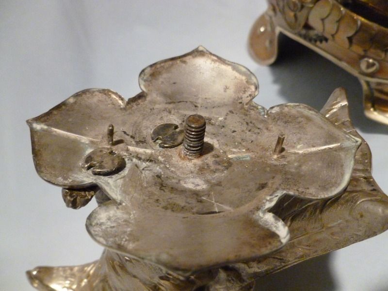

The base. Remember, there's just a square nut and washer in place of the wing nut, not worth photoing.
The tail:
More in the next post

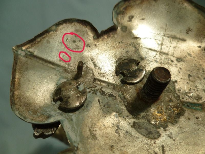

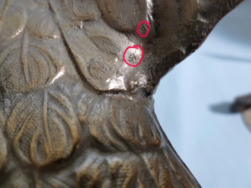

poniatowski

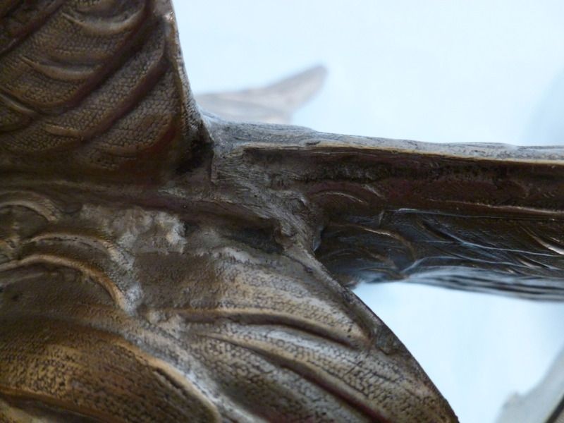

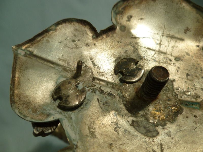

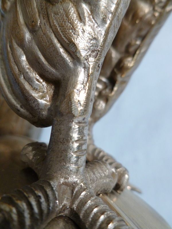

A few rough spots:
The legs show file marks:
Soldering by the wing roots:
THESE areas look very suspicious to me.
I just love tearing m'self a new arse hole, but if we can all learn from this…
poniatowski

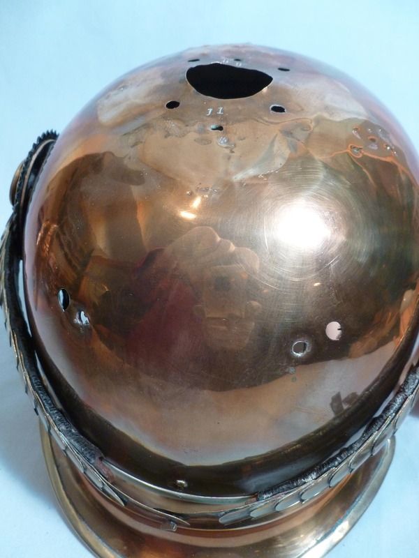

Here are more. If you look at the re-soldered posts on the back of the plate, as well as the extra holes in the helmet, you can understand why I'm extremely suspicious of this as a parts helmet. If I'm right, I actually wouldn't mind converting it back to a 6K helmet, since that regiment is my favorite. :)

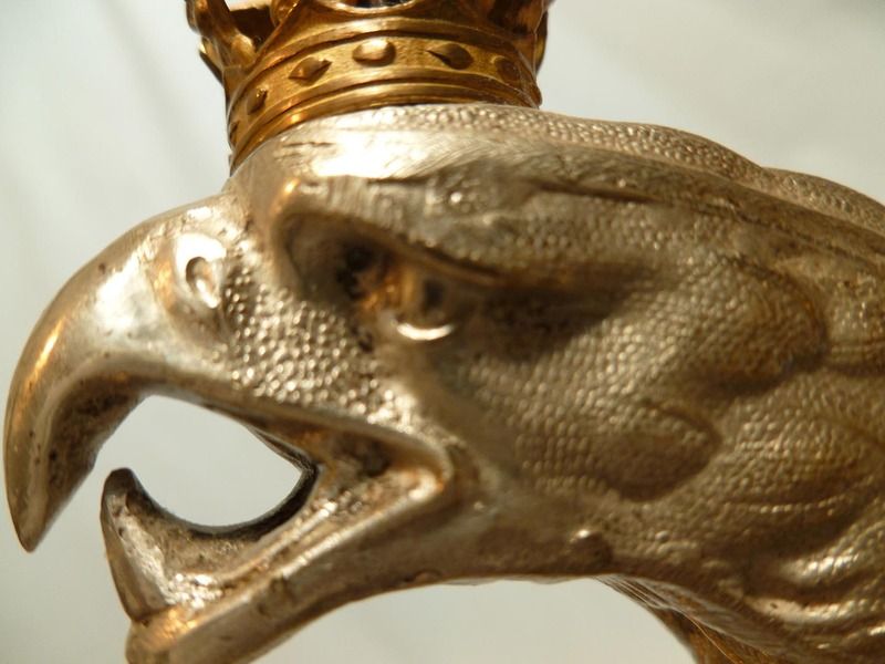

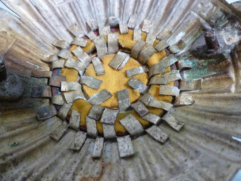

Frist, another close-up of the head.

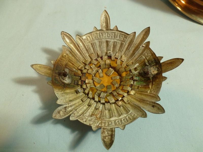

Now the wappen:
And finally the extra holes in the body of the helmet:

Dragoner08
Ron , it is very hard for me to determine your eagle in the pictures.
I think, that the base plate is ok. The screws are correctly. But the eagle worries me. Look please at the marked areas ! These areas give me problems.
The face of the eagle is usually very clean. But here is not the case.
The wing tips appear to be a little short. This eagle I would scrape with a steel needle in an inconspicuous place !
The emblem think is original . But the threaded rods have been added. The silver plating is burnt ... it's not ok .
It is very hard for me to say something on to these images.
Can you please still images from the inside of the helmet to adjust ?
Gruß Gunnar

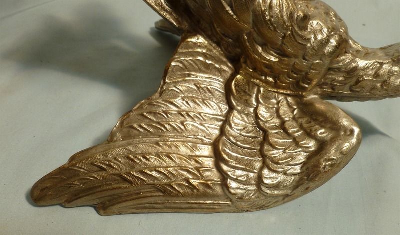

Which part of the inside of the helmet do you need photos of? The liner isn't in the best of shape, so I don't go poking around in there a lot.
I'll also take photos of the wing tips from the bottom or top so you can see the true contour.
Thanks again!
poniatowski

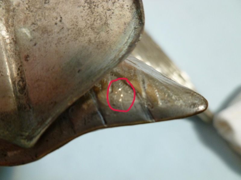

Okay, well, I scratched it and there's only sliver below. I'm not sure yet. I'll have to take it out into the daylight to be sure. I'm still thinking it's a replica eagle.
Here's a better photo of the wing contour.
poniatowski
Okay, I took a look at the eagle under bright white light and there is brass showing through the silver on the wings, so that's a copy / fake. The star wasn't original to the helmet, so it's all parts thrown together. I don't think it's worth discussing the thing any more. The only thing good I can say is that the person who sold it to me thought it was 100% good and back in the 1980's the references weren't what they are today. So, it was fun to think it was all good, but I started to have doubts ten or more years ago, when I saw some originals up close in Germany.

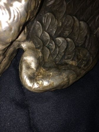

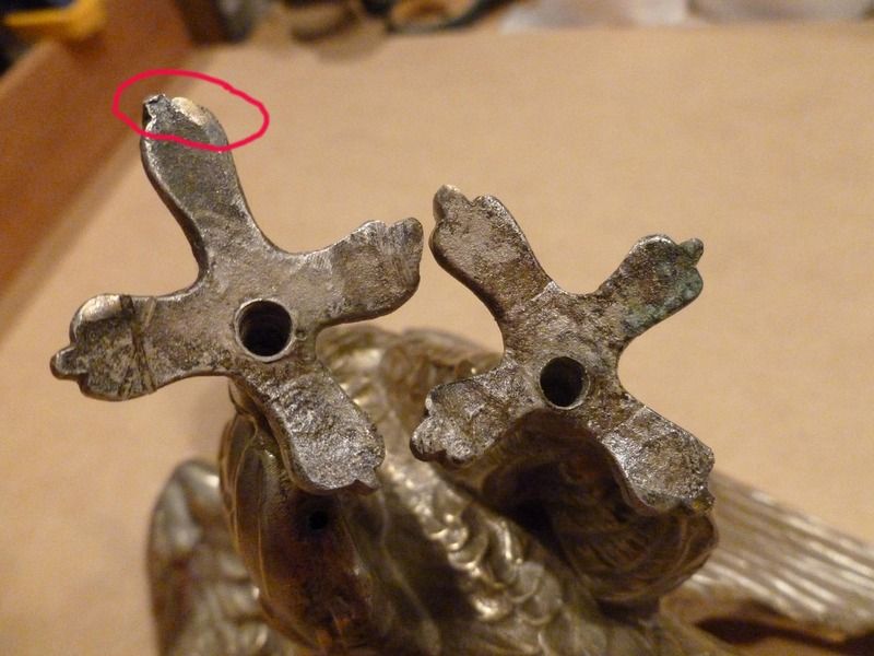

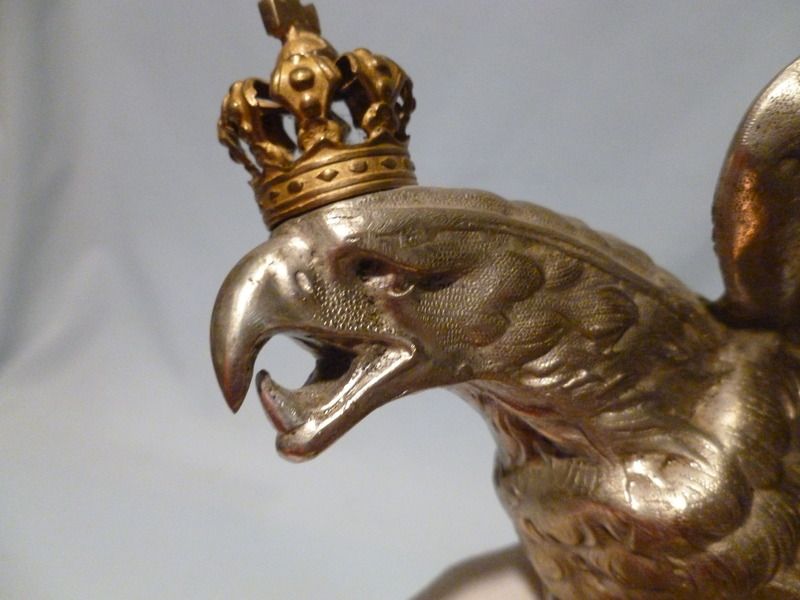

Okay, just a few more photos of details so others can see:
The bottoms of the talons / feet:
You can see a brass / nu-gold scrape in the circle. ("Nu-gold" is a yellower alloy of brass that is less prone to tarnish. I say this because we used this a lot when I taught are metals and this looks like it.)
These are obviously castings. Would that be right for an original as well? I've never seen the bottoms of an original's talons.

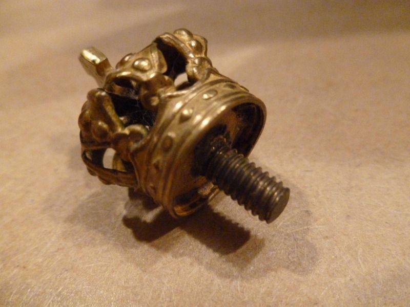

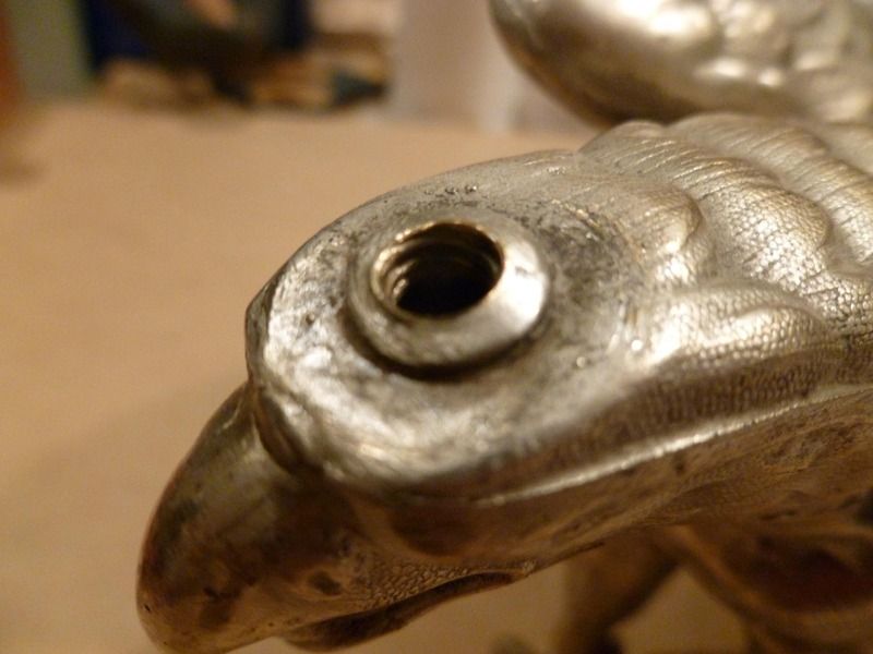

The top of the head, crown removed:
And, the crown:
To me, the crown looks good / original. There's some gilding (pale yellow) on it. However, any comments are welcome. :)

Dragoner08
It is really not easy to judge something on images . The crown looks good for me . But when the base material is made of brass , which is a sign of a new production at the eagle.
The whole casting beads also suggest
Gruß Gunnar
poniatowski
Gruß Gunnar
I agree. How new would that be? 1970's at the latest.

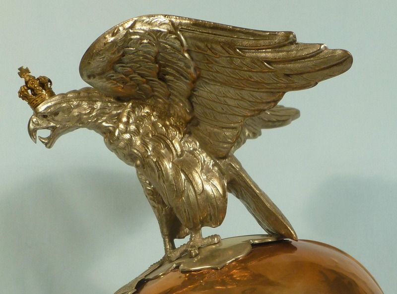

Here's what I'm seeing: A silver plated brass eagle, which can't be right. The beading on the face is suspicious. To me (having worked with metals in both jewelry and welding / brazing) the small beads look like spatter from brazing or soldering the brass. The back of the plate has had the posts re-soldered in a very sloppy fashion, indicating that it wasn't done by the military or a helmet dealer / manufacturer, so has been messed with and its placement on the helmet isn't correct.
Next week: weigh the eagle. I would be willing to bet it comes in well over 500g, but I don't have a way to do this without bringing my gram scale from work. So I'll do that and it will probably settle this once and for all! :)
So, the feet are not cast on originals? I'm trying to get this all sorted in case I'm ever wealthy enough to purchase one at today's prices. I'm wondering about this because Richard's eagle also looks to have cast feet and a brass base metal (evident on the foot photo). Maybe he could weigh in here?
richesz28
Hi Ron,
I have purchased the eagle you mentioned for a very fair price and am waiting for it to arrive. I looked at as many as I could find on the internet and have seen several in person. I believe it's an original piece, but I have to wait until it's in my hands. I do know the weight is 400 grams, though, that is without the base and crown. It should arrive in the next week or so and I will update this post after I get it.

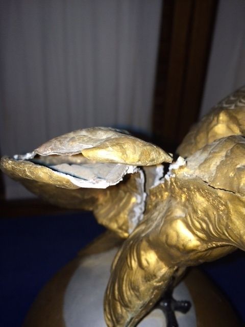

I have an original eagle for my GdC but it is heavily damaged and virtually irreparable. That's why I was interested in this one. My original eagle is made of pewter and someone painted it gold with black feet and eyes. Looks horrible but it is a real one. See picture below. The photo only shows a small part of the damage. The wing is folded almost 180 degrees near the tail where it meets the body and as the picture shows the wing is split in half and bent. I've contemplated a variety of fixes for it over the past couple of years and cannot find an economic way to repair it. It was more feasible to get a replacement eagle if I could find one. I think (hope) I got lucky. With the new eagle on the way I can work toward restoring the rest of the helmet. It needs a liner and some minor metal massaging but is in pretty good condition.
