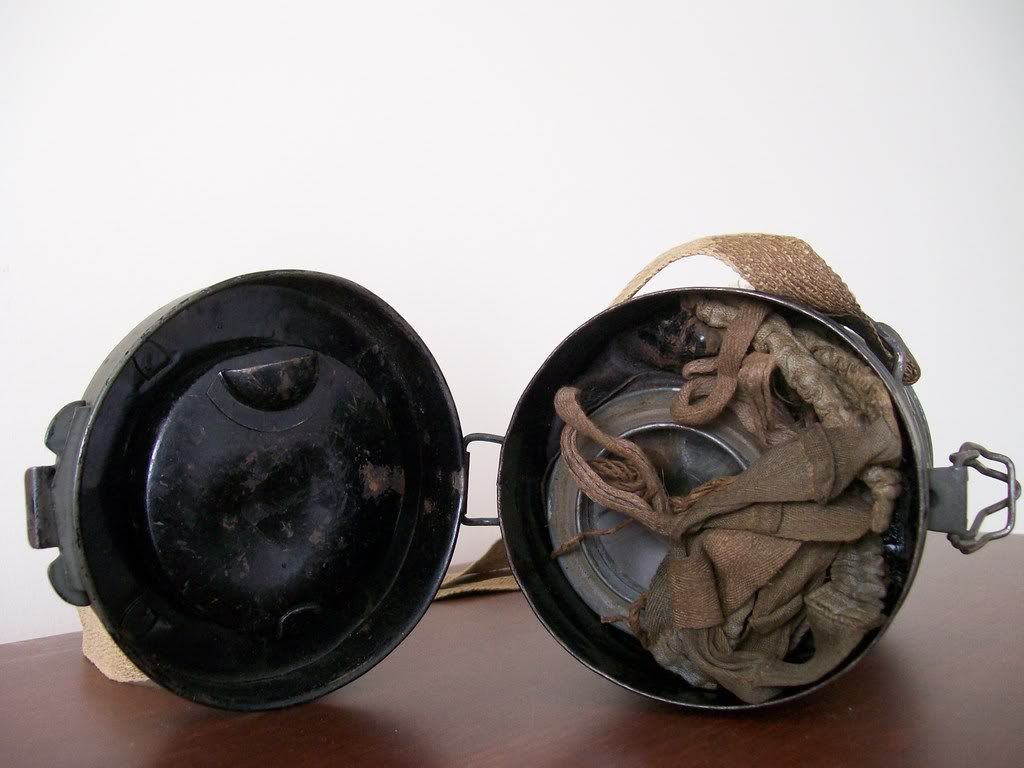

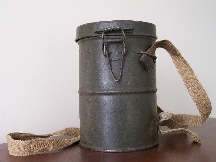

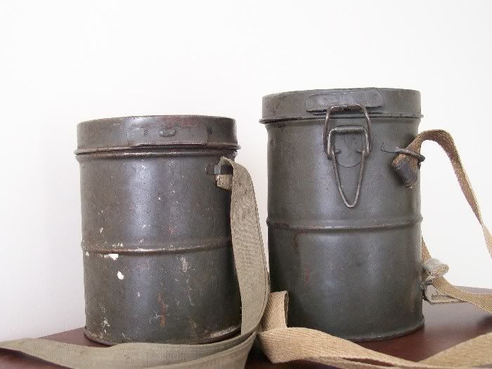

This picture shows the difference in size between the early Gummimaske can on the left, and the larger GM 17 Lederschutzmaske can on the right.
The GM 17 can's carrier straps are made of Ersatz woven paper (papercloth), which is typically seen on these cans.

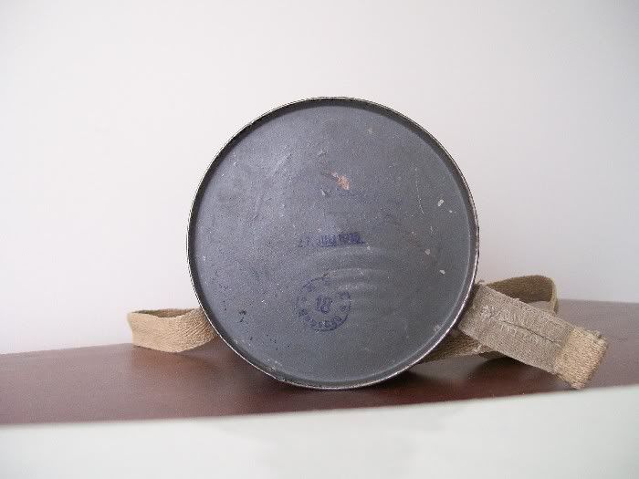

The can is dated July 27 1918
The filter on the mask is dated 14 September 1918 (no pictures yet)

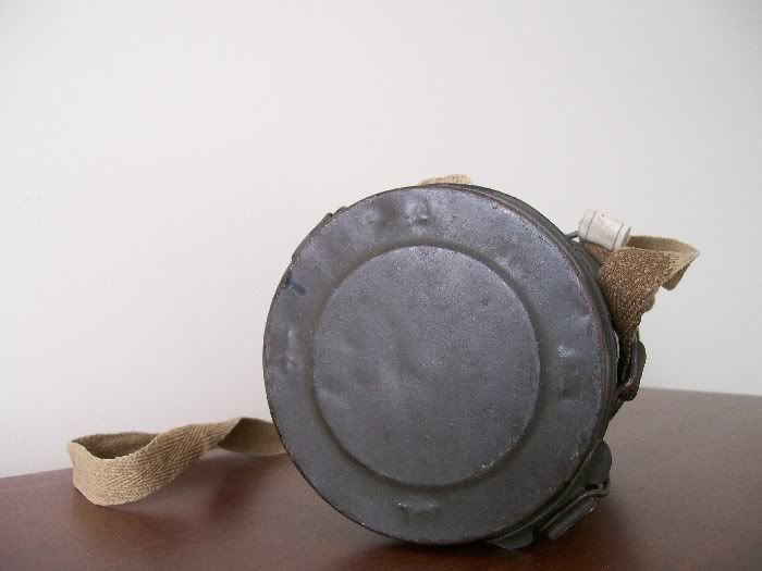

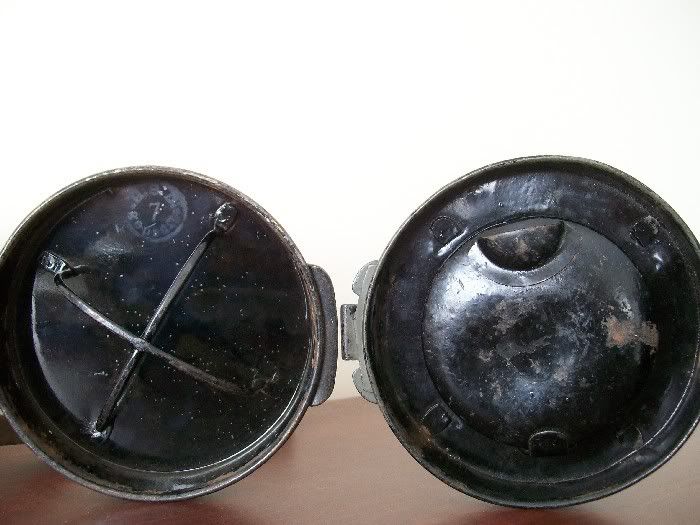

This can has one interesting feature. The lid is made from a recycled M15 carrier can model. In this picture you can see traces of where the wire cage was once attached. On the left is a lid from a M15 can for comparison showing the wire cage feature.

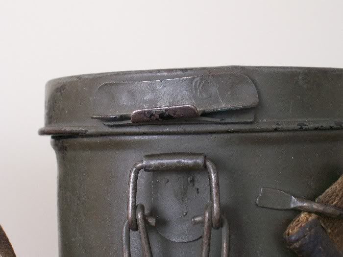

The M17 clasp fastener was attached overtop of the earlier model opener (lip), which was cut down a bit in length.
The top of the lid shows how it was reworked to extend room for the spare lens compartment, and also the impression of the wire cage attachment showing through.
