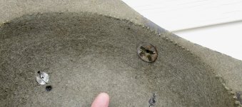

The inside of the empty shell. This is one of the thick hard shell versions of filz helmets. For some reason, most of the original liner stitch holes have disappeared. I have stuck a T pin into one as a sort of guide ??

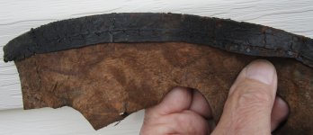

This is the original liner that I have been sent to stitch into this hat.

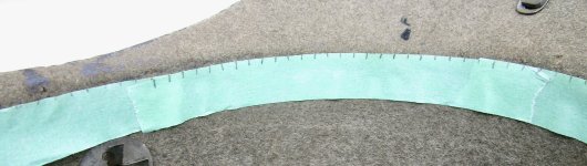

As the original stitch holes have disappeared, I have to remark them in pencil. I have an original helmet from my collection to work from.

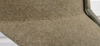

The original example that I have to work from.. My helmet is the same thick hard felt but does not have the rear spine. The stitch holes here are 5 mm apart as they are on Mathew's liner.

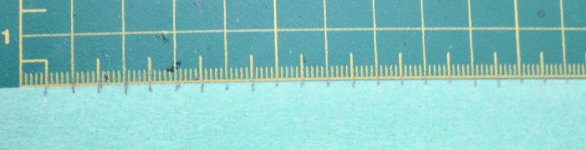

A close up of the stitch line on the donor liner.
