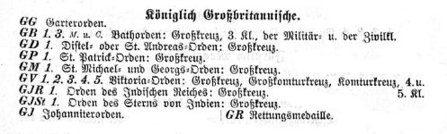

this from the 1910 Prussian Army List. All British orders were abbreviated with an initial letter G (as indeed were Greek orders).

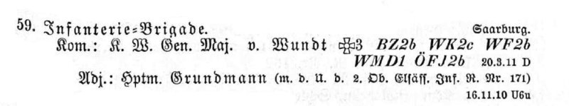

This one I managed to ID today. He is clearly a Württemberg General Officer as shown by the Württemberg Friedrich Order Commander's Cross at the throat, the Württemberg Crown Order on the breast and the Prussian Red Eagle pushed into 2nd place behind the Long service decoration. Throat decorations; the Baden Zähringer Lion and what is that hiding under the Zähringer Lion? - It is an Austrian Franz Joseph Order. The photograph must date after 1910 as his Waffenrock is configured as full dress; so the hunt is on for a Württemberg Major General between 1910 and 1914.....Easy. Not quite! On checking the Württemberg section of the Prussian Army List between 1910 and 1914, there is no General Officer with that combination of awards?? Curses!!
So a couple of possibilities: a retirement promotion to Generalmajor or more likely a Württemberg officer seconded to Prussia, that does appear to be a Prussian helmet plate. Next step: check all the full colonels from 1910 onwards and bingo: Oberst Theodor v. Wundt (1858-1929), commander of Infanterie-Regiment König Wilhelm I (6. Württembergisches) Nr. 124 in 1906-1910. Fast forward to 1911 and we find Royal Württemberg Generalmajor v. Wundt as commander of the Prussian 59. Infanterie-Brigade in Saarburg. General v. Wundt commanded 59. Infanterie-Brigade from 20 March 1911 until his retirement and promotion to char. Generalleutnant z.D. on 22 March 1913.,
General von Wundt served in WW1 as commander of 51. Reserve-Infanterie-Brigade 1914/16 and 18. Reserve-Division in 1916/17.

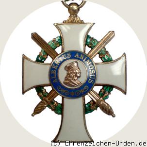

Albrechtsorden Ritterkreuz 1.Klasse mit Schwerter (2. Form)
SA1X
DA
RAO4
KO2
The Prussian breast star has me flumexed!
Hi Joe,

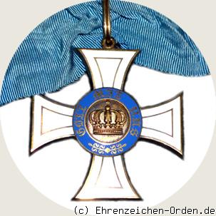

good going, although the Saxon Albrecht Order Knight's Cross our subject is wearing does not have the swords. The Crown Order is a 3rd Class. You will struggle trying to find a Prussian breast star of the type he is wearing, or any German breast star for that matter. :-" This order is really what makes our subject here interesting and for that matter indentifiable.
