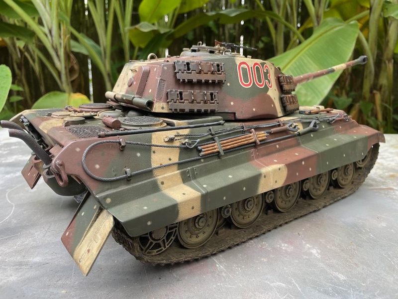

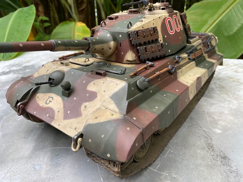

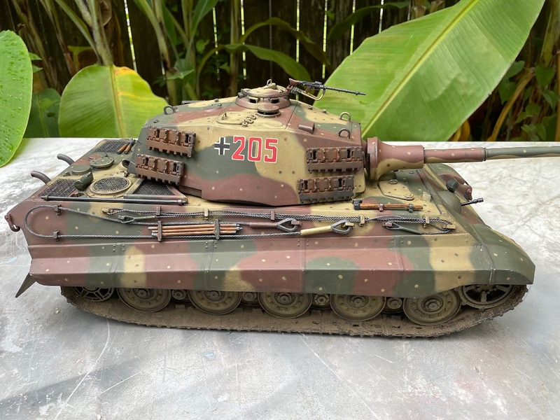

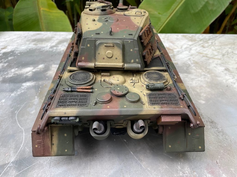

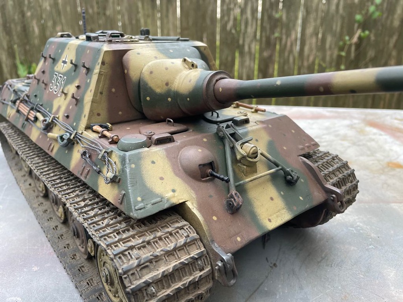

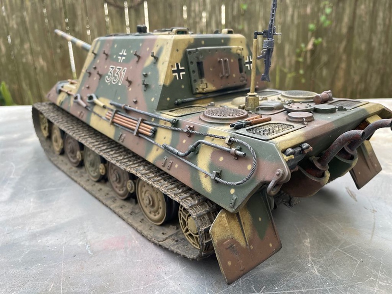

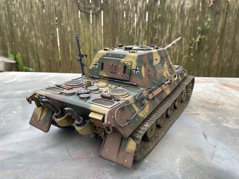

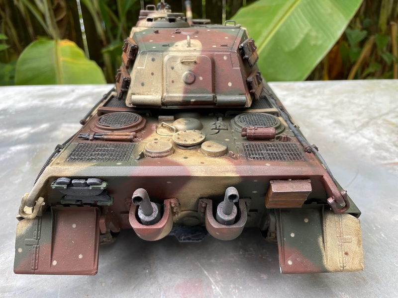

This next King tiger was orderd from a guy who had a painting of 003.
The scale was not quite right in the painting but he wanted it just like the painting.
I think I got it close.

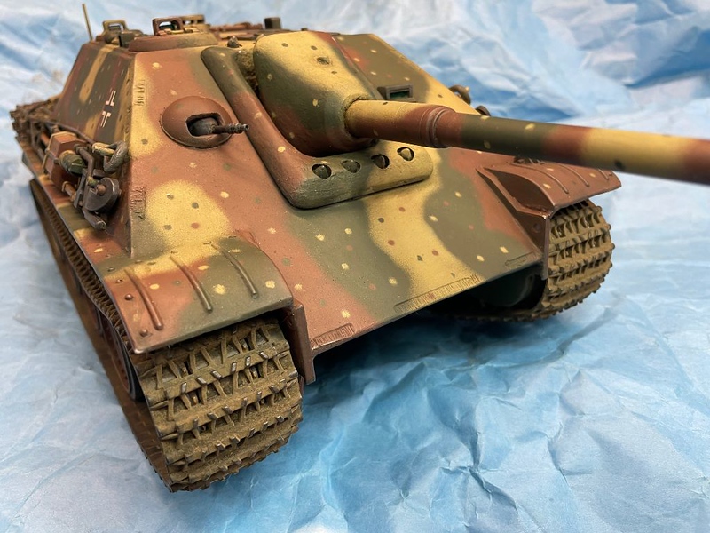

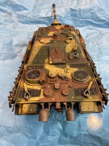

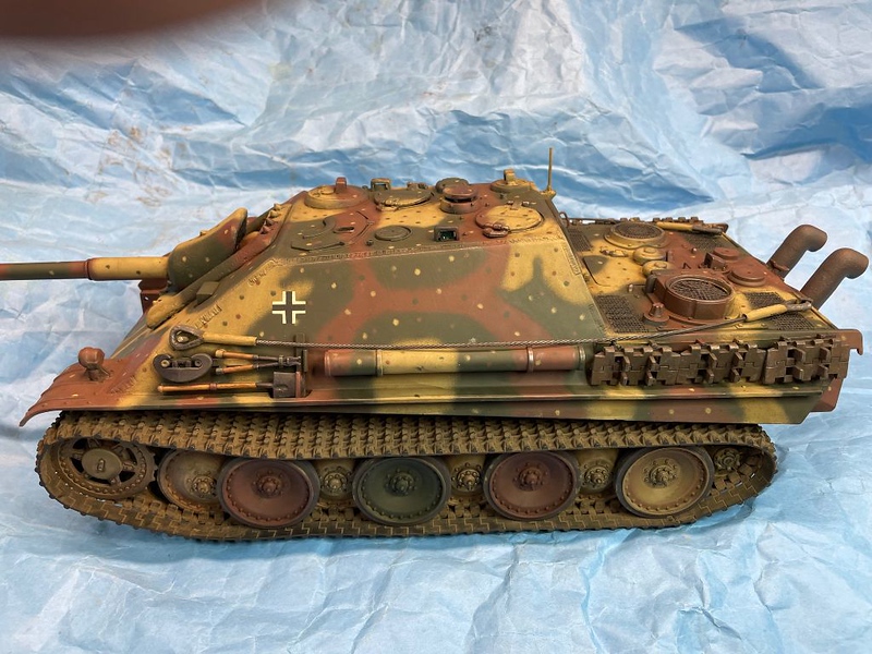

This is what I have on the work bench now or at least trying to copy it. This Jagdpanther is 1/35 scale and will be a challange to make it in 1/18th scale.

I make these out of resin.
I made the prototypes ( 1/18 scale ) out of styrene.
I broke it down into parts made molds of the parts and casted them.
THESE ARE NOT STORE BOUGHT MODELS I HAVE TO MAKE THEM !!!
I do not do decals
I have a sign maker close by who cuts stencils for me.
All of the markings ( crosses, stars numbers ect. ) are painted on

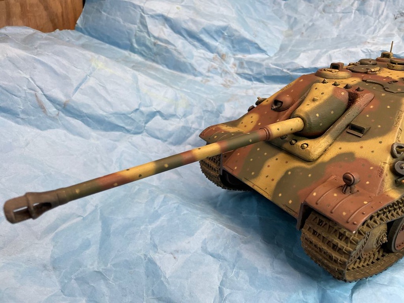

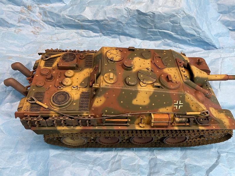

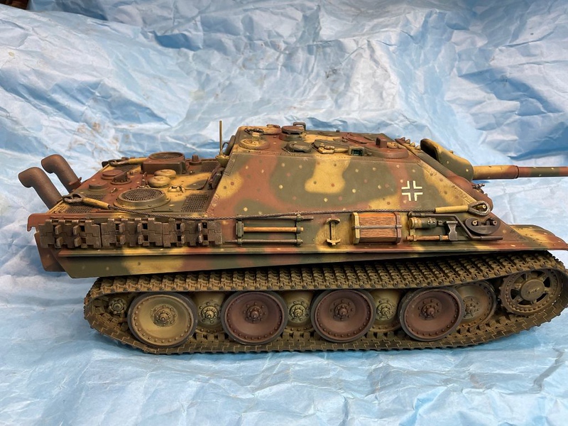

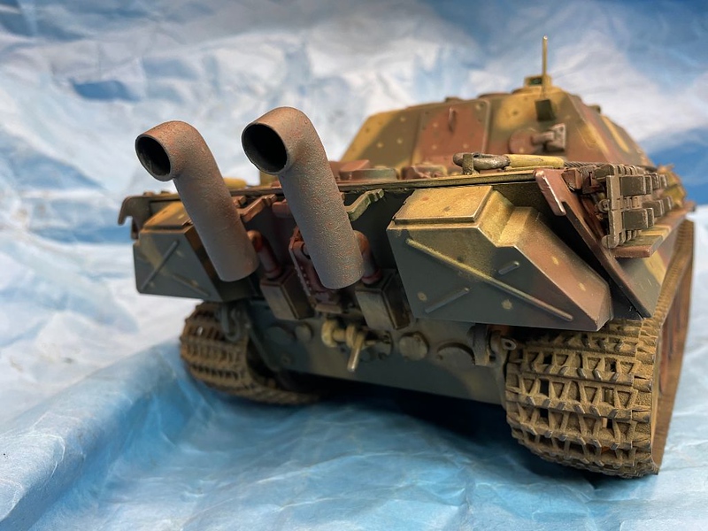

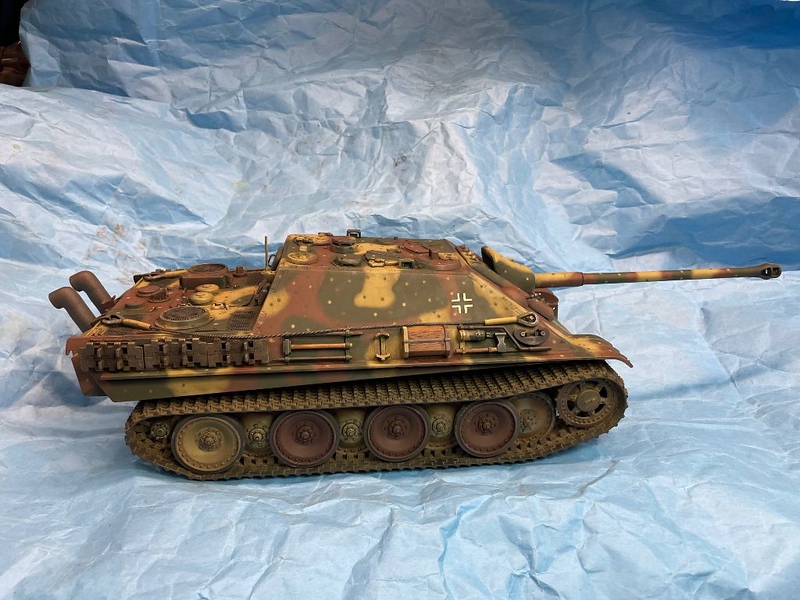

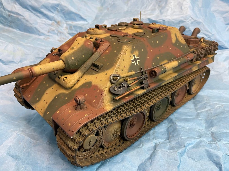

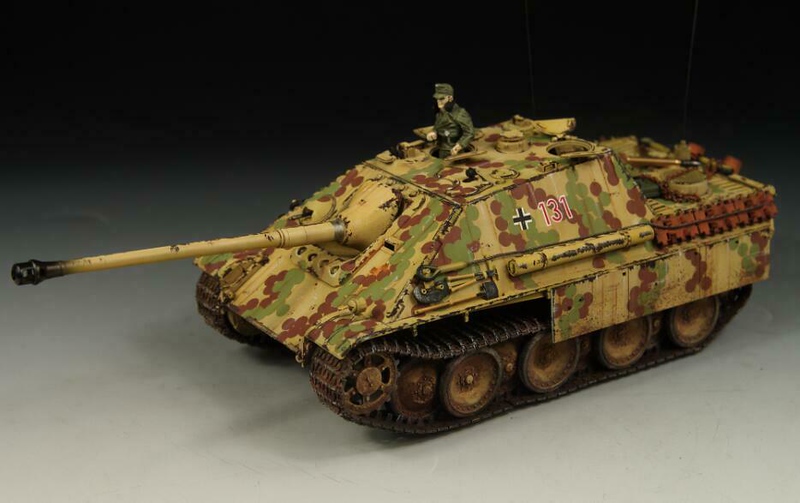

I finished this Jagdpanther about 3 months ago.

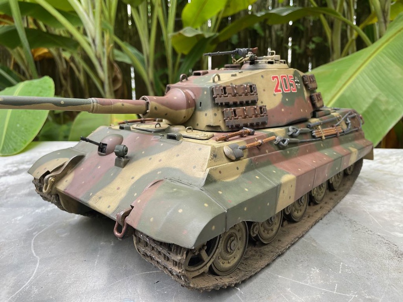

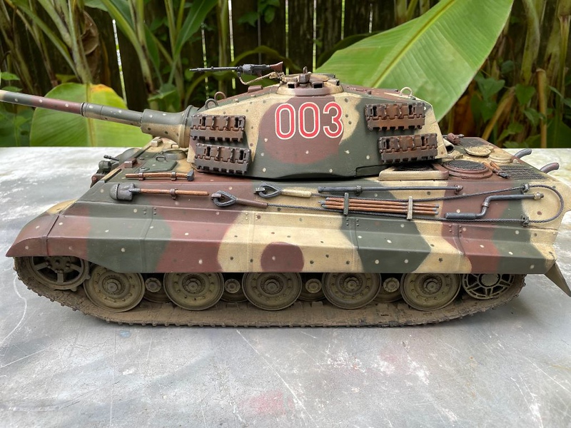

This is my second run for the King tiger.
My first run I made the track links ( stiff resin ) one by one. LOTS OF WORK !!!
Too much work in fact so I made long lengths for the top and bottom run with singles around the rear ideler and front sprocket. STILL TOO MUCH WORK
Now I made new molds again and I use a rubber type resin and I make the tracks in 2 pieces and they wrap the running gear like rubber bands
