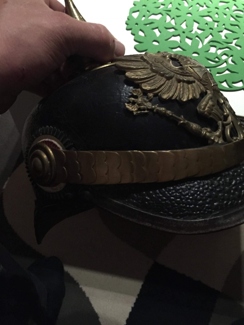

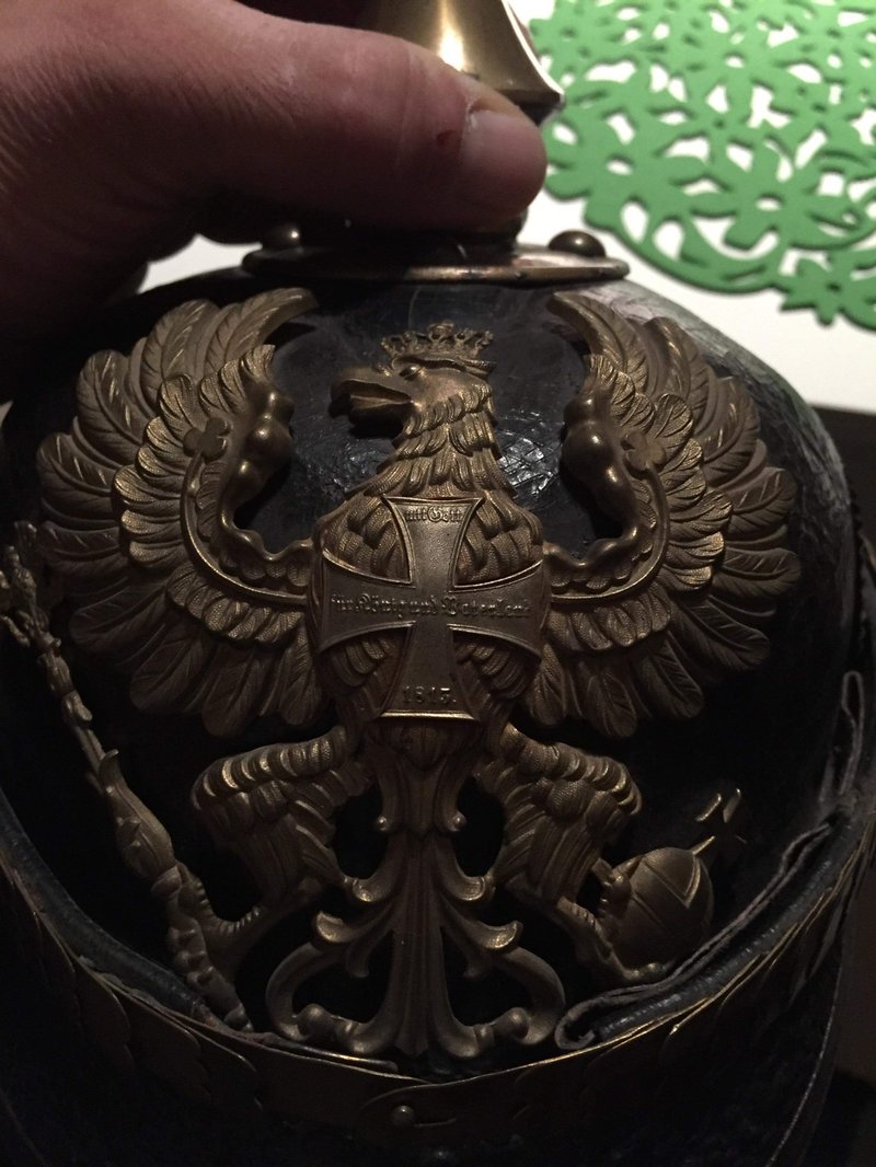

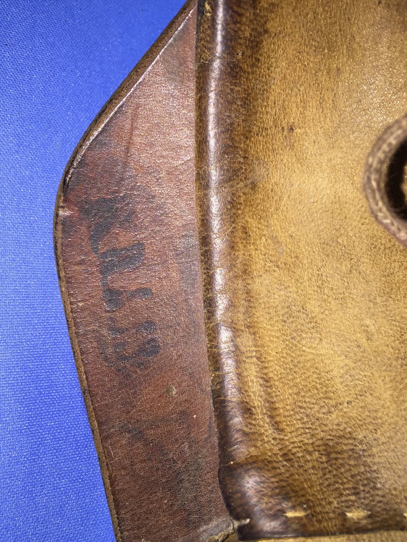

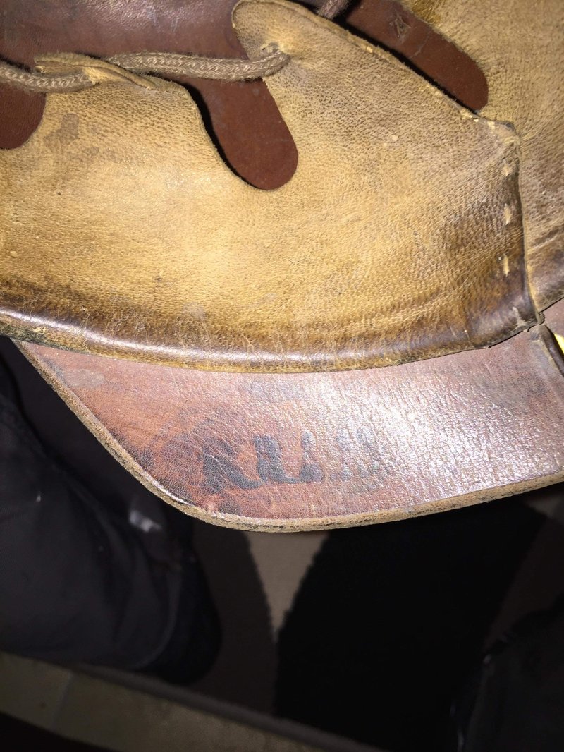

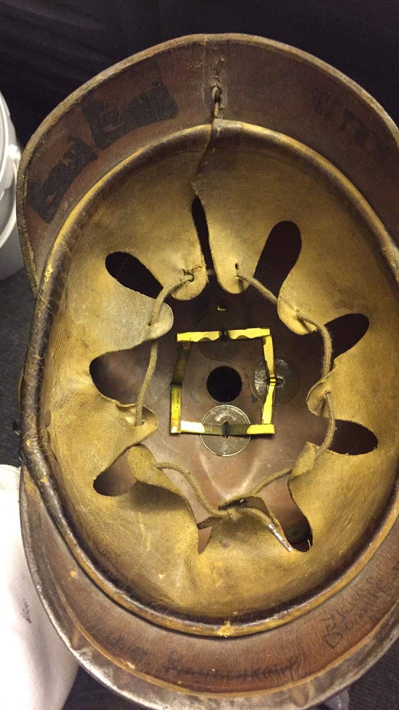

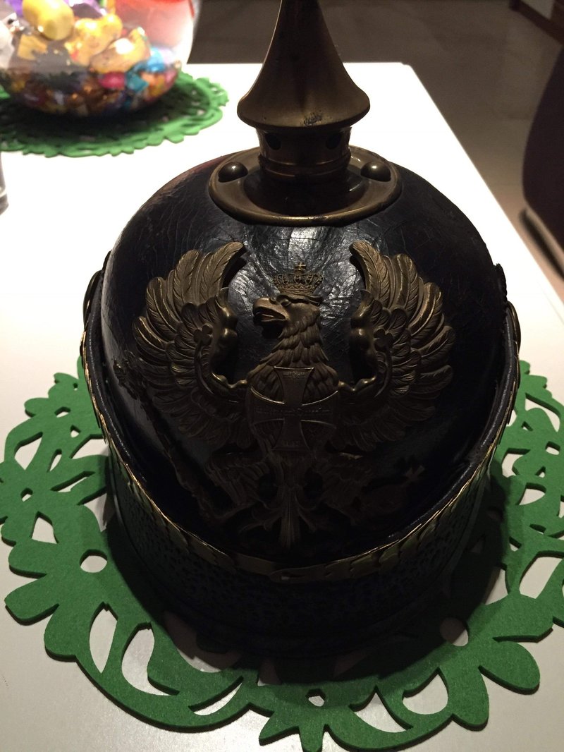

Next week my second Pickelhaube will arrive
This time ist is a prussian Reserve "other ranks"
unfortunately i have this time only the shown pictures... but maybe it its enough for a first opinion

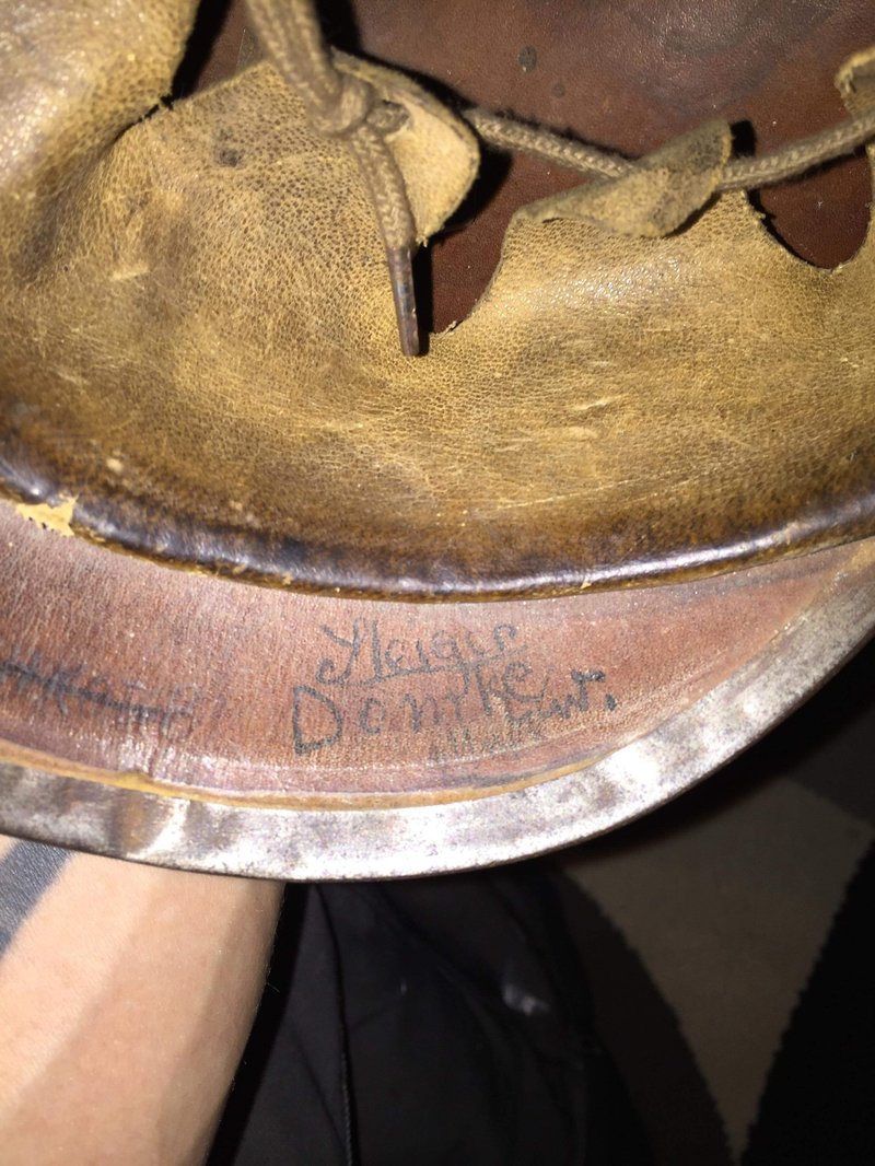

The helmet must have given from "hand to hand"..there are many owners names inside.. and a few stamps, which i cant read on the pictures
when she arrives, i will show much better pictures for sure

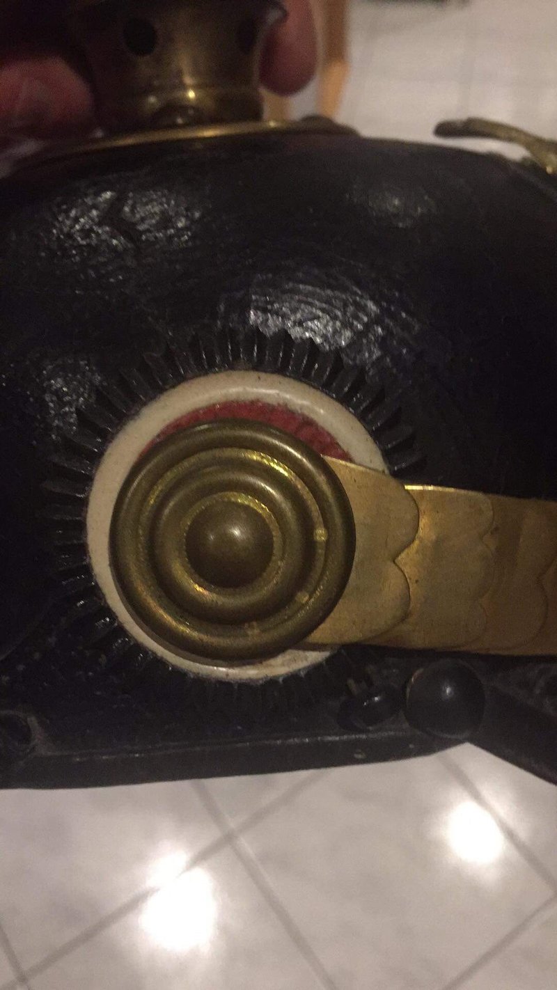

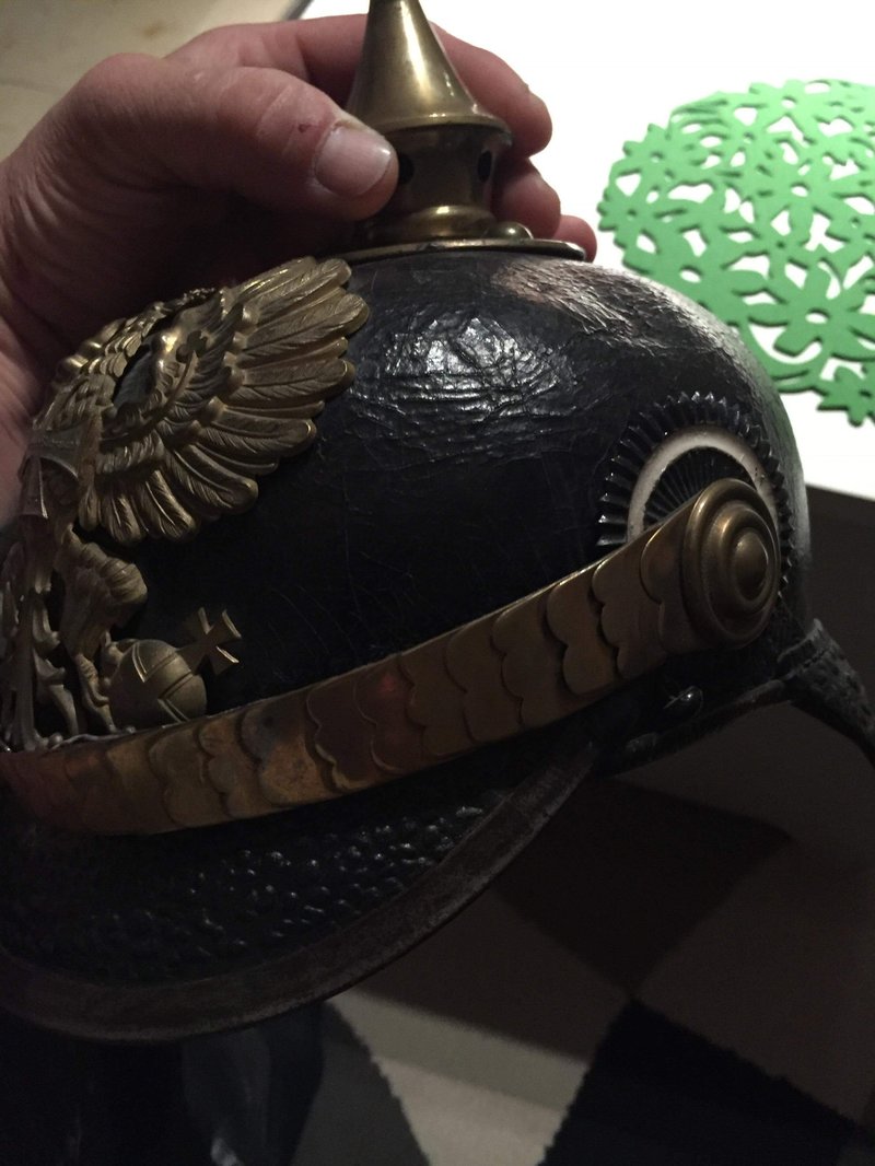

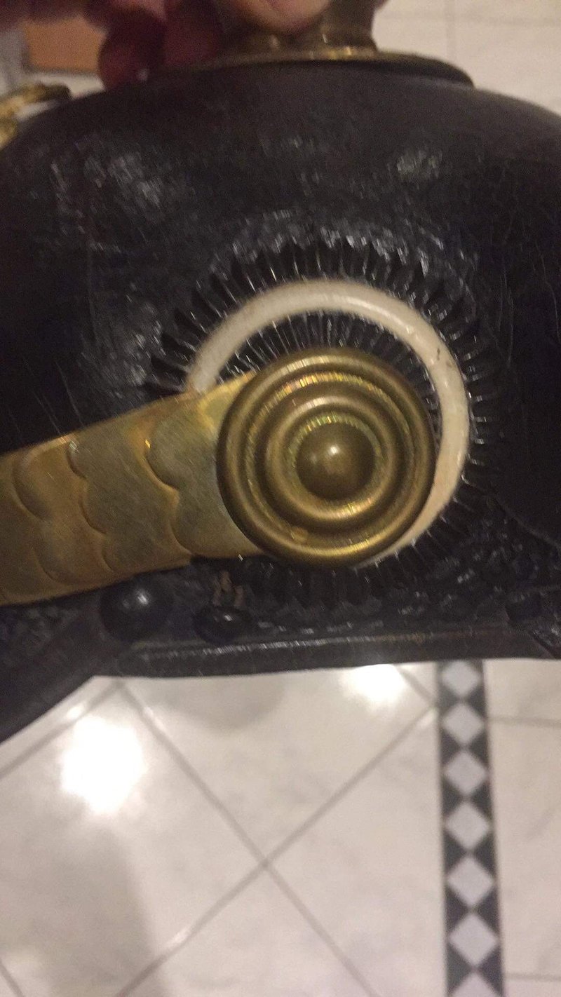

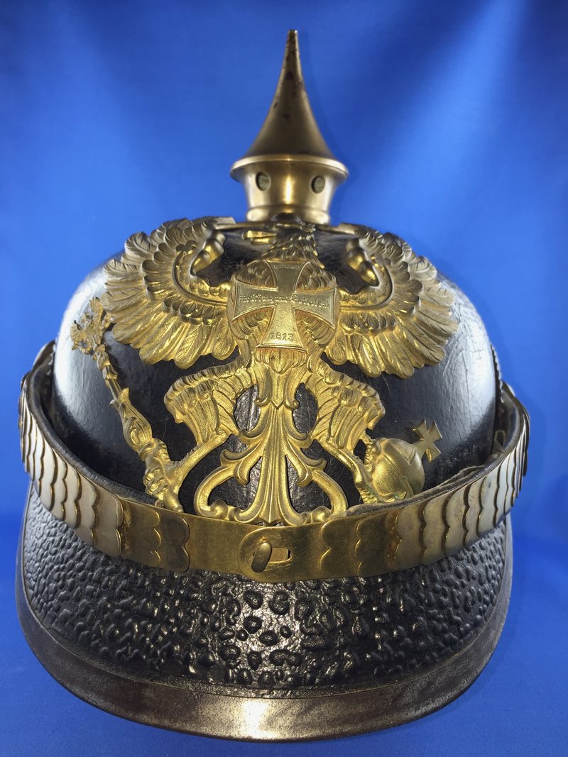

Well, I hate disappointing you but the eagle is for an officer helmet, spike base attachments are wrong, the front visor rim is iron, coming from an M15 model, and the spine is at least broken, and possibly missing. Looks like a put-together helmet... sorry.

The large cross on the wappen indicates Prussian Landwehr not reservist. The spike base brads are repros because the prongs are too long and shiny. The front visor trim does look to be M15 steel. The liner is also a model 1915 style as it is undyed , a natural leather colour. The older style of chin scales which have been put on this helmet do not match this liner. To match, the liner would be dyed black. It is also my opinion, that this is a fireman's helmet dressed up to be a pickelhaube. Many hauben were converted to fire helmets after the war. They have a brass or white metal “comb” which runs down the top of the helmet to the back. These combs cause a matching depression in the top of the shell, you can see this depression both on the inside and outside of the shell. So this piece has been faked and put together. Do not feel bad Thomas, we have all made mistakes when beginning our hauben collections. Please post some better fotos of this but I really feel that you will need to send this one back for a refund.

Also thanks for this information.. i will post good pictures when she artives.. i got her by an exchange.. i think i will hold her for an example how it should NOT look...
It´s the nature of the things that you somtimes have to pay some „learning money“ when you enter a new sector of collecting..
Maybe there is a way to make her „correct“.. we will see...

Post by b.loree » Sat May 19, 2018 1:25 pm
An example of the fireman's "comb" that was put on this helmet after the war:
You will note that the depression seen in the top of the shell, matches this shape.

Yes.. you are right.. i didnˋt noticed that on the dark pictures.... this was in the theme Pickelhauben my first fault.. surely not my last.... thanks for your explanation

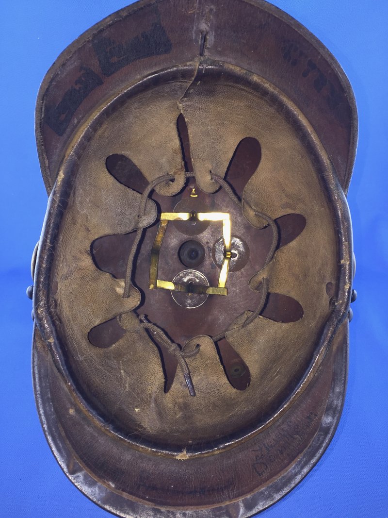

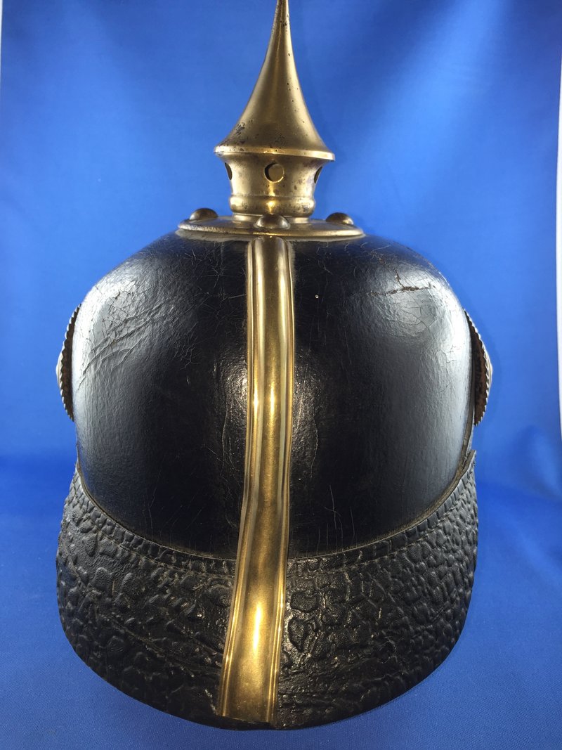

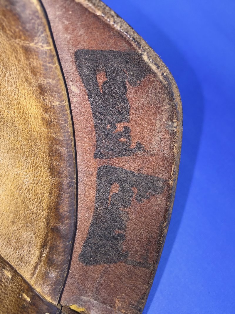

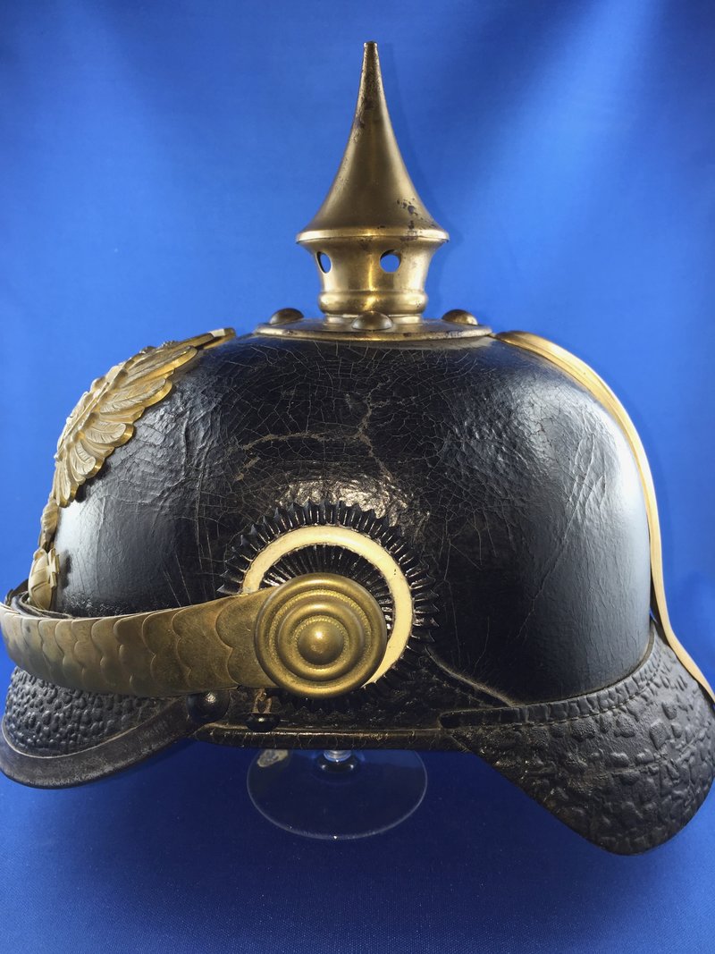

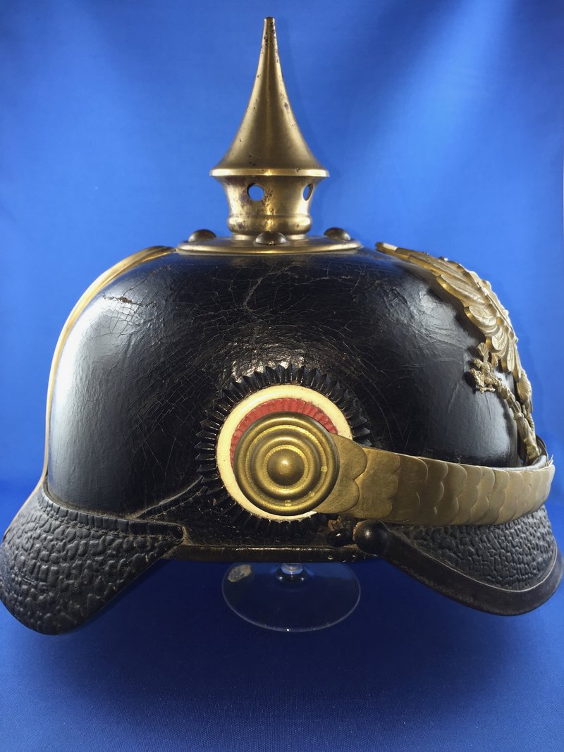

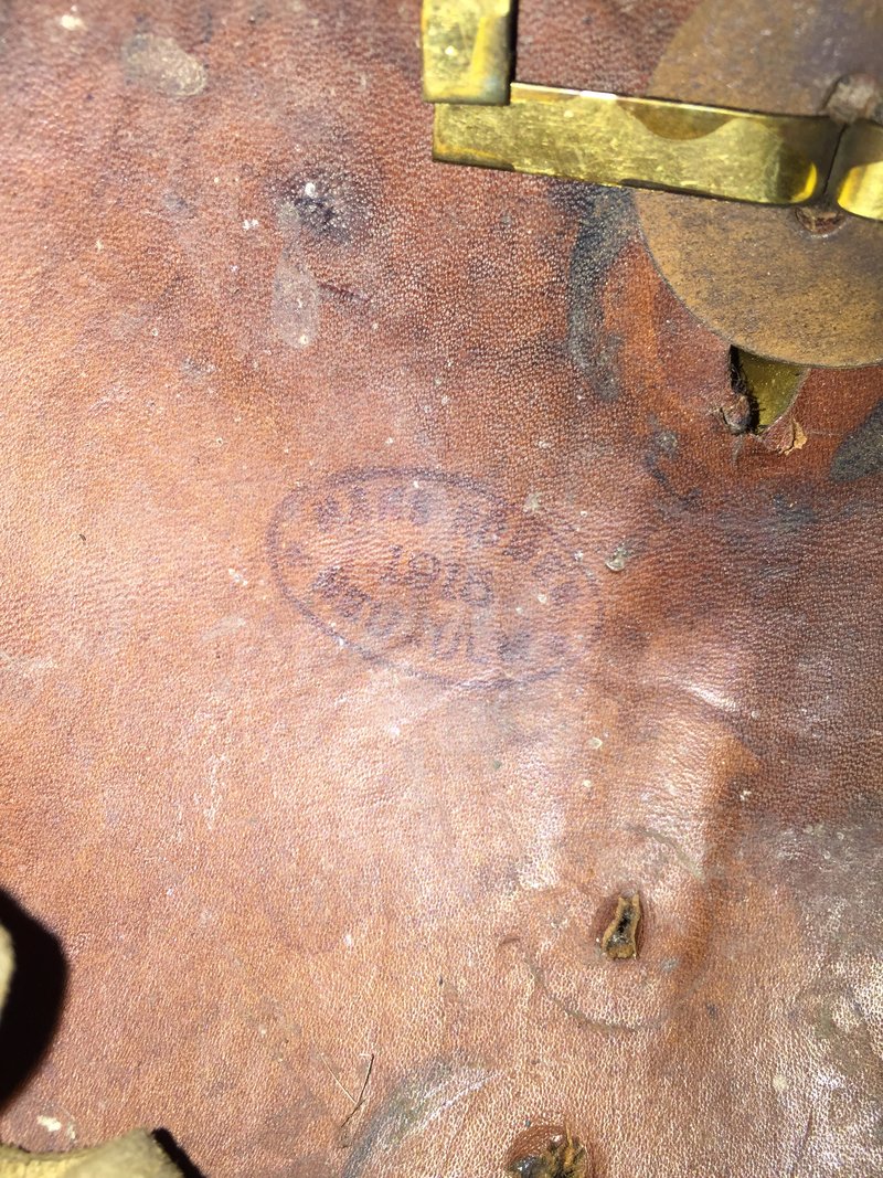

The second Pickelhaube has arrived...
And you all were right... You can see clearly the imprint of the Kamm or Ziegelbrecher. The rear spine is broken off at the bottom, the visor trim is silver..
There are some stamps they i cant´t read.. inside is one dated 1916

Yours looks to me to have been a M15 once, made by Hans Römer in Neu-Ulm, in 1916.
And after the war made in a firemans helmet, and later was made a pickelhaube again, but using the wrong parts from a M95.
You could try to buy the correct M15 spike, a wappen and some correct posts for it, or leave it as is.
The reservist wappen is worth money, so are some of it's other parts.

Your helmet is definitely a parts helmet , but the parts do have value so do not feel down .
Spike--------------------------- $45-$65
Reserve Off plate ------------$150
Flat brass chinscales ---------$250
Chinstrap rosetts --------------$35
Silver front visor trim --------$35
Damaged rear Off spine -----$15
Riechs/Prussian cocardes----$100-$150
Fireman's shell with liner--- $50-$75
So all is not a loss your helmet is NOT worthless.
