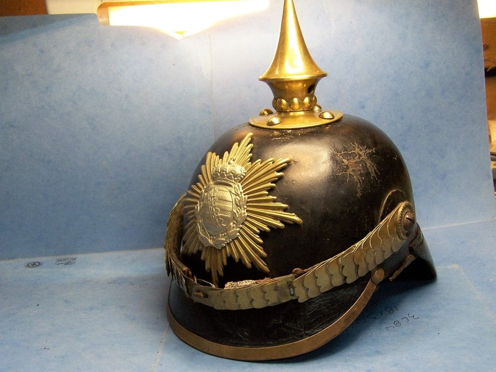

It took me over 10 years to get all of the parts for this rebuild.

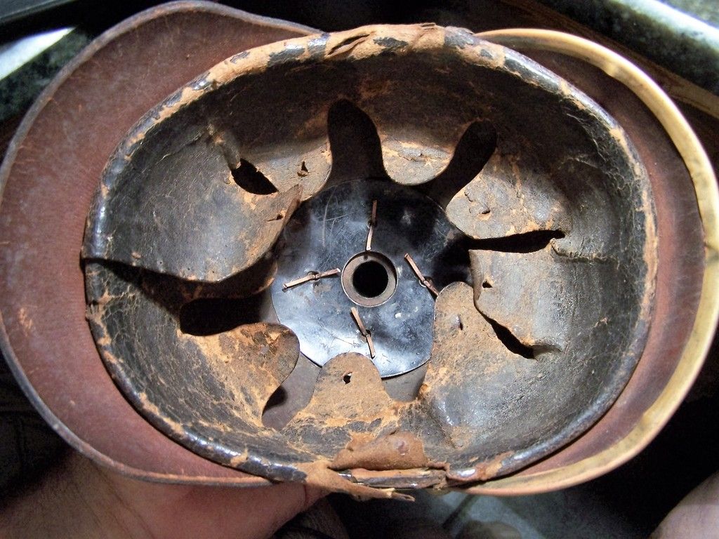

Many years ago I got a 1867 Saxon shell with wappen, cocarde and spike with back up plate .
The spike mounting plate is SMALL about a 1/2 smaller than a standard type spike base.
I was able to find original chinstraps ( missing a few scales ) and slotted bolts along with a non perferated rear visor .
Just a couple of weeks ago I found a correct front visor that was a little off but I could get it to work.
I just finished it up after taking a birthday weekend off to work on a relatively easy project.
This is my only 1867 spineless and I feel lucky to have it.
Now how do I display it ? Front out or back out ?

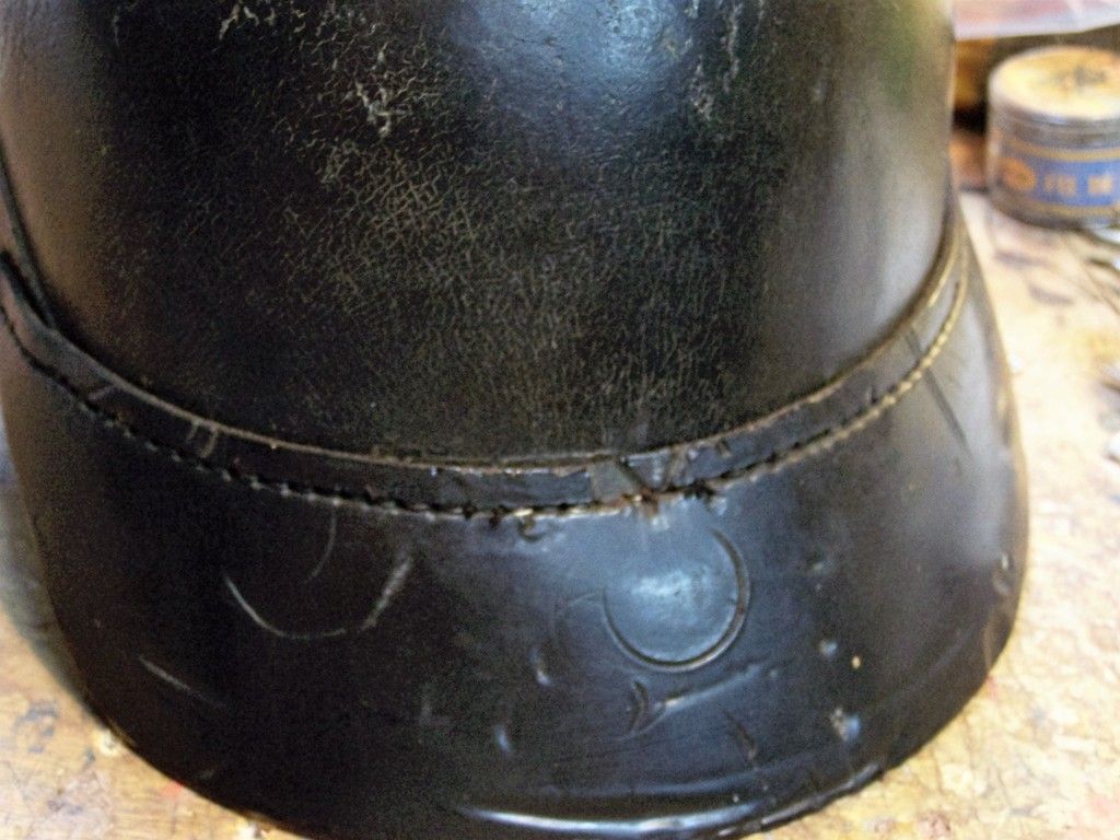

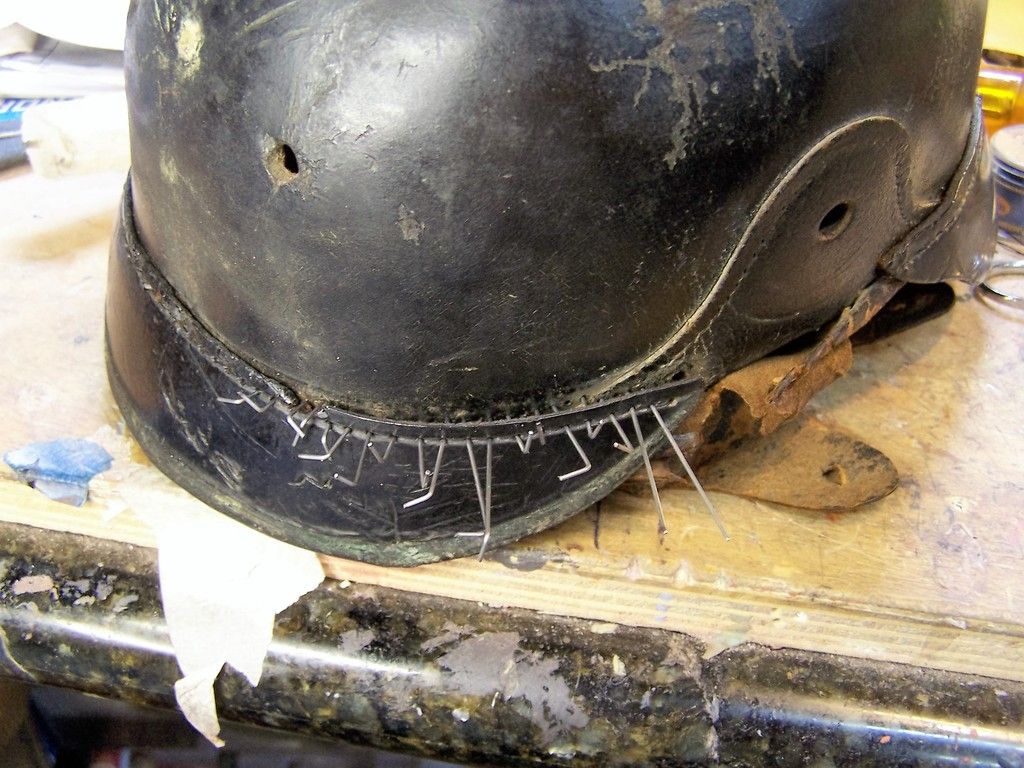

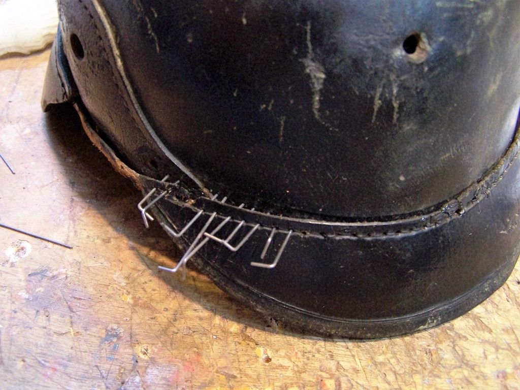

I started by using a very thin drill bit in a Dremel and ran it through the holes in the visors and dome.
Then using .5 mm French waxed linen thread.
Once I found the center line on the shell and visor, I put a few stiches to hold the visor in place.
I found that filing off the point on my thin 2 inch needle made all the difference in the world . A pointed needle will stick in the leather . Using a dull needle you are able to probe the holes and it makes threading SO MUCH EASIER.
I had some thin piano wire that I used to align everything up.
Threading one half over and under then coming back over and under the opposite to finish the stich line.
Then repeat the other side.

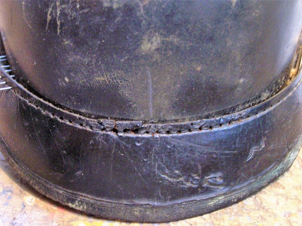

I had to repair a few tear outs. 100 year old leather is some what fragile

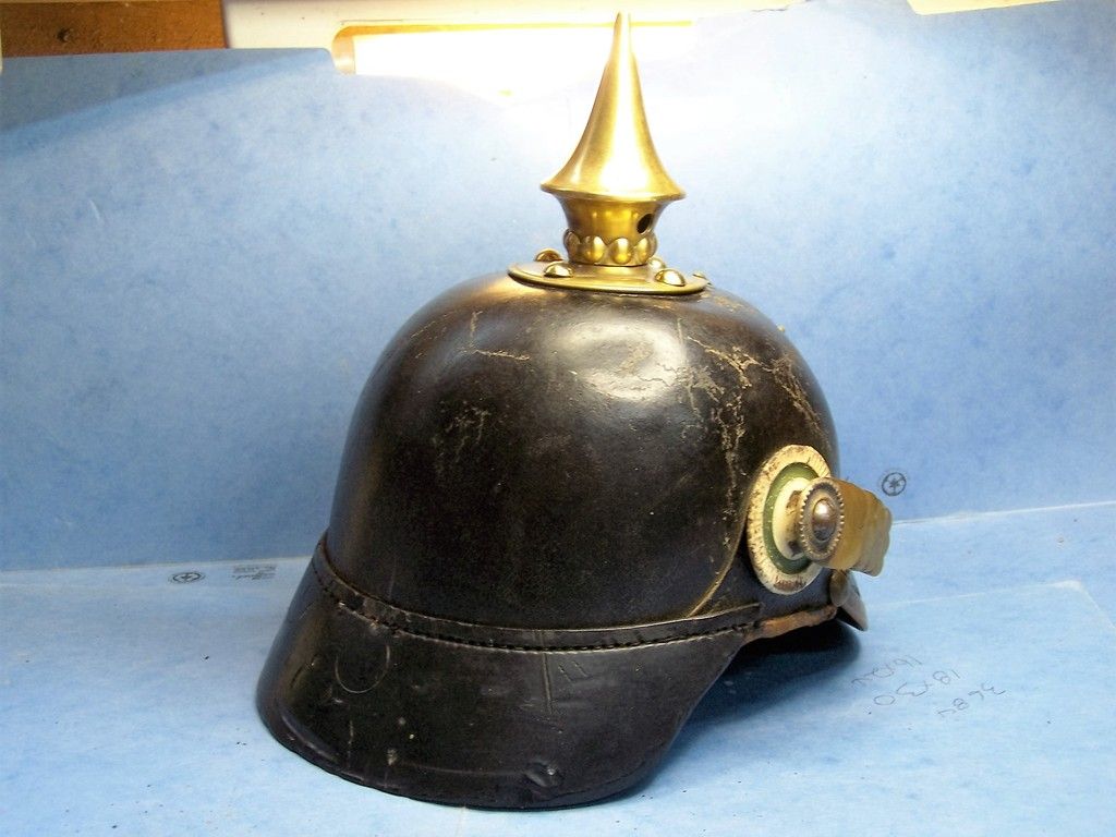

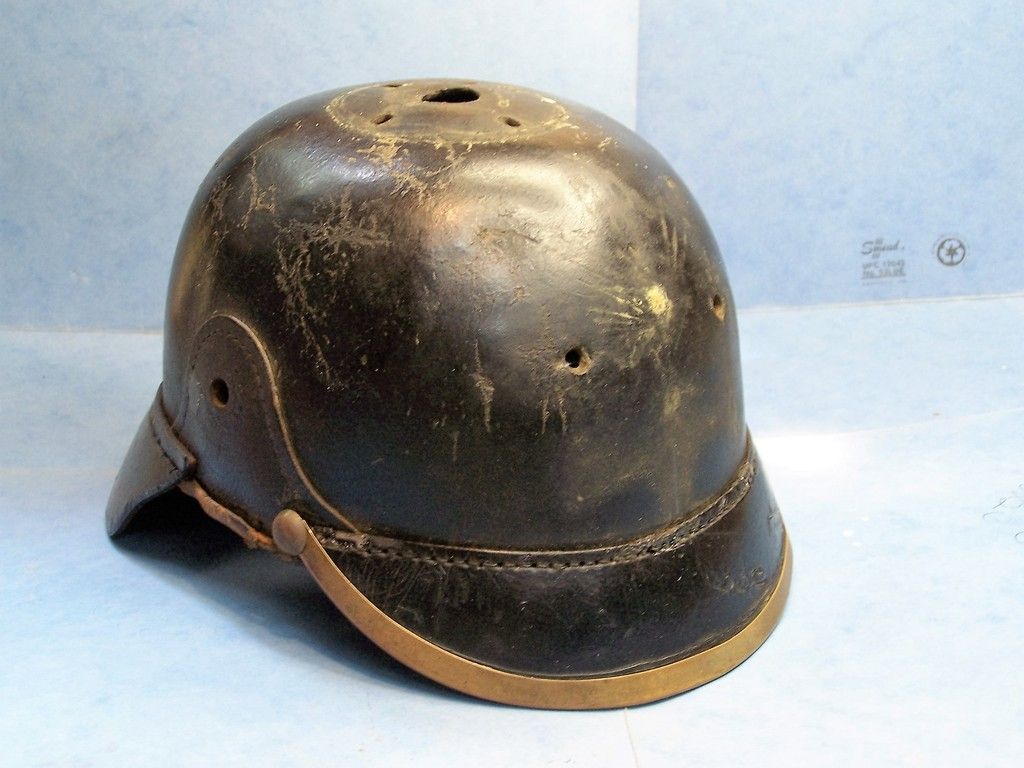

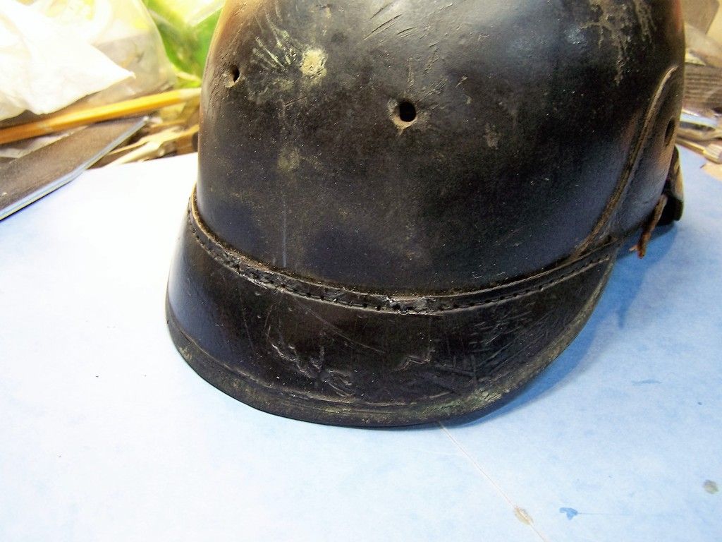

Once done I did the back.
The front visor trim was just a little long so I had to cut about 4mm off the ends to make it fit tight.
Just a little fill o that back visor.

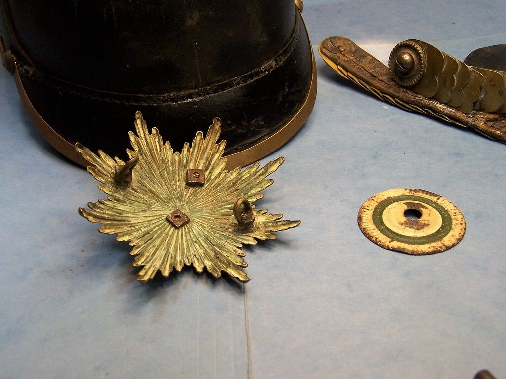

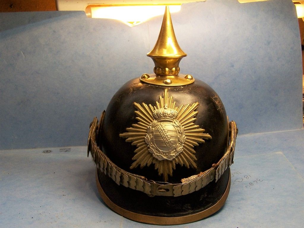

Correct plate and cocarde. Or should the cocarde be bigger ? Don't know so this is what I am going with.

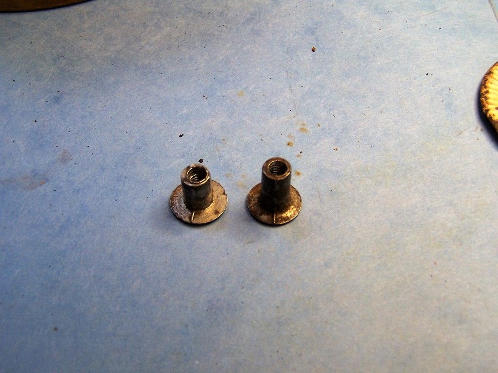

The screw bolts were different sizes so I used the long bolt backing on the right side to accommodate the cocarde .
I have Randy T trying to track down some screw rivets so repos will have to do for now.
Just a few little repairs on the ear areas and screw studs and this redo is a wrap !!
So this year marks this helmet at being 150 years old fitting to restore it on my 58 year birthday weekend !!

Congratulations Matt on doing an excellent job on that old beauty! :thumb up:
